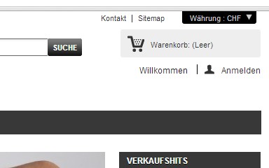

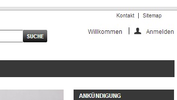

Castello Bianco Posted May 31, 2013 Share Posted May 31, 2013 (edited) Hi I have exactly the same problem (1.5.4.1) . After a lot of trials in relation with http://www.prestasho...ght-how-to-fix/ I have realized that the root of the bug is the in the Catalog Mode disappeared cart. Shop Mode Catalog Mode Unfortunately I couldn't find the solution . Thank you for any help . Castello Edited May 31, 2013 by Castello Bianco (see edit history) Link to comment Share on other sites More sharing options...

vekia Posted June 1, 2013 Share Posted June 1, 2013 hello! it's because in "catalog mode" there is no cart (from block user info module). in this case modification of css is necessary. here is the solution: open /modules/blocktopmenu/css/superfish-modified.css add padding-top:40px; to: .sf-contener { clear: both; padding-top: 40px; } 1 Link to comment Share on other sites More sharing options...

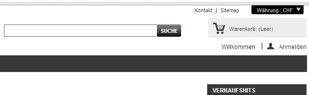

Castello Bianco Posted June 1, 2013 Share Posted June 1, 2013 Hi vekia Thank you very much for your feedback. I tried your suggestion and it works fine in the catalog mode. Your solution fits as long as I don't switch between the shop and catalog mode (I do that when I am in holidays ;-) ). In the shop mode the padding in the blocktopmenu makes a large (ugly) space. Catalog mode with vekias solution Shop mode with vekias solution (with large space) Maybe theres an other solution neccessary that works in both mode catalog and shop? Thank you for any help!! 1 Link to comment Share on other sites More sharing options...
vekia Posted June 1, 2013 Share Posted June 1, 2013 As far as i know there is no other (as simple as this) solution, which will work both in catalog and normal mode. Of course it is possible to achieve this, but with huge modification of header. It's better to add / remove padding-top:40px; than to rebuild header at all - believe me Link to comment Share on other sites More sharing options...
Castello Bianco Posted June 1, 2013 Share Posted June 1, 2013 Hello vekia Thank you for your support. Your solution helps as a quickfix and needs always a system modification by switching between the modes. I would prefer a final solution which could be used by shop assistants (non-technicians). I hope the problem will be fixed by an official update soon. Thank you again for your help!!! Link to comment Share on other sites More sharing options...
