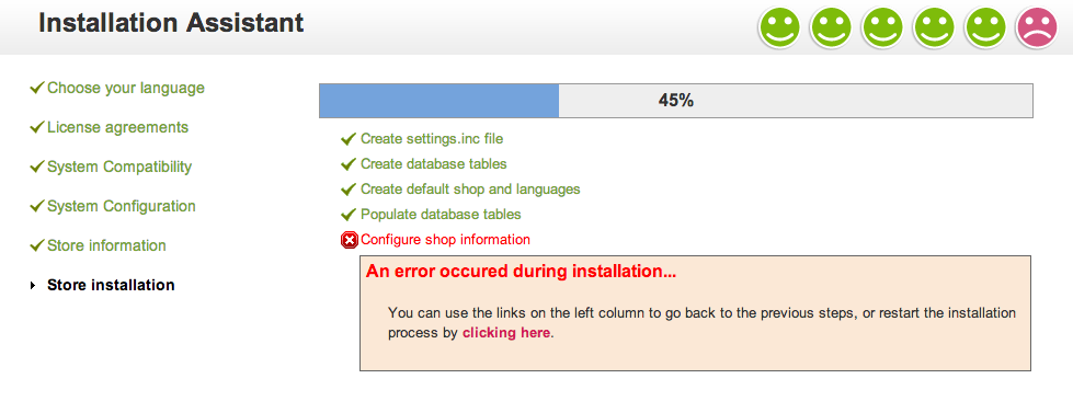

jc87 Posted May 26, 2013 Share Posted May 26, 2013 Hi, I have previous work with Prestashop before with 1.5.2, had no problem installing it on the server as well as my localhost with MAMP. But with this newer version I tried 1.5.4 and 1.5.4.1, I get the same error at 46% when is at the "Configure shop information" stage. Any ideas? [26-May-2013 16:06:13 Asia/Hong_Kong] PHP Fatal error: Uncaught exception 'PrestaShopException' with message 'Property Currency->decimals is not valid' in /Applications/MAMP/htdocs/yuniques/classes/ObjectModel.php:837 Stack trace: #0 /Applications/MAMP/htdocs/yuniques/classes/LocalizationPack.php(259): ObjectModelCore->validateFields() #1 /Applications/MAMP/htdocs/yuniques/classes/LocalizationPack.php(50): LocalizationPackCore->_installCurrencies(Object(SimpleXMLElement), true) #2 /Applications/MAMP/htdocs/yuniques/install/models/install.php(456): LocalizationPackCore->loadLocalisationPack('<?xml version="...', '', true) #3 /Applications/MAMP/htdocs/yuniques/install/controllers/http/process.php(213): InstallModelInstall->configureShop(Array) #4 /Applications/MAMP/htdocs/yuniques/install/controllers/http/process.php(95): InstallControllerHttpProcess->processConfigureShop() #5 /Applications/MAMP/htdocs/yuniques/install/classes/controllerHttp.php(171): InstallControllerHttpProcess->process() #6 /Applications/MAMP/htdocs/yuniques/install/index.php(32): InstallControl in /Applications/MAMP/htdocs/yuniques/classes/ObjectModel.php on line 837 [26-May-2013 16:15:21 Asia/Hong_Kong] PHP Fatal error: Uncaught exception 'PrestaShopException' with message 'Property Currency->decimals is not valid' in /Applications/MAMP/htdocs/yuniques/classes/ObjectModel.php:837 Stack trace: #0 /Applications/MAMP/htdocs/yuniques/classes/LocalizationPack.php(260): ObjectModelCore->validateFields() #1 /Applications/MAMP/htdocs/yuniques/classes/LocalizationPack.php(50): LocalizationPackCore->_installCurrencies(Object(SimpleXMLElement), true) #2 /Applications/MAMP/htdocs/yuniques/install/models/install.php(453): LocalizationPackCore->loadLocalisationPack('<?xml version="...', '', true) #3 /Applications/MAMP/htdocs/yuniques/install/controllers/http/process.php(211): InstallModelInstall->configureShop(Array) #4 /Applications/MAMP/htdocs/yuniques/install/controllers/http/process.php(95): InstallControllerHttpProcess->processConfigureShop() #5 /Applications/MAMP/htdocs/yuniques/install/classes/controllerHttp.php(171): InstallControllerHttpProcess->process() #6 /Applications/MAMP/htdocs/yuniques/install/index.php(32): InstallControl in /Applications/MAMP/htdocs/yuniques/classes/ObjectModel.php on line 837 Link to comment Share on other sites More sharing options...
vekia Posted May 26, 2013 Share Posted May 26, 2013 maybe try to install with english localization pack, (i've noticed that you trying to install it with Asia/Hong_Kong - Am I right?) then after installation, you will be able to import localization pack in back office Link to comment Share on other sites More sharing options...
jc87 Posted May 26, 2013 Author Share Posted May 26, 2013 That's interesting. It worked when I switch the country and timezone to US. I don't think there was a problem with 1.5.2 before... Anyways, Thanks. Link to comment Share on other sites More sharing options...
