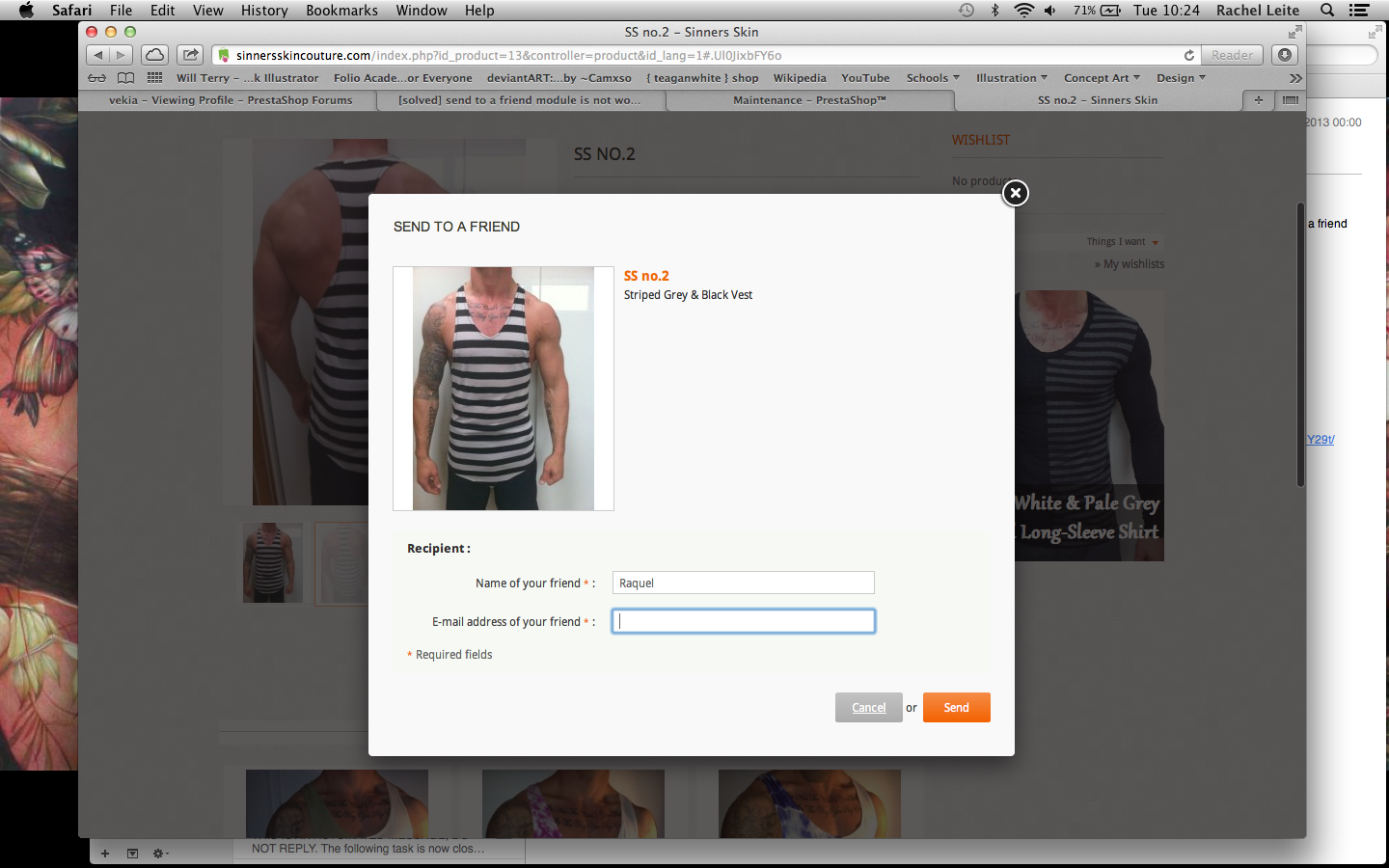

rhleite Posted October 15, 2013 Share Posted October 15, 2013 (edited) Right, so first off, I am using the current version of prestashop 1.5.6.0. The theme I'm using is ClassicStore. And my website is: www.sinnersskincouture.com When I click on one of the products, where I can view all the the size,add to wish list, favourites etc...I click on Send To Friend, and a pop up appears with the pic and the fields to enter friends name and email, when i put name and email and click on "send" nothing happens. So I asked the theme developer what was up, and he said " "please switch to default prestashop theme and check this issue in it" Again, I wouldn't even know where to begin. I tried doing what was reccomended by others on this form but it's still not working. thank you Edited October 15, 2013 by rhleite (see edit history) Link to comment Share on other sites More sharing options...
vekia Posted October 15, 2013 Share Posted October 15, 2013 i inspected code of your website there is no "form" so it isn't possible to use "send" button. i think that you should follow your dev suggestion. switch for test purposes theme to default under preferneces > themes tab in your back office Link to comment Share on other sites More sharing options...
rhleite Posted October 15, 2013 Share Posted October 15, 2013 (edited) Okay, I switched to Theme Default...But what do I do now after I switch? Will I lose all my work when I switch to the default theme? Hi hmm, my friend is coming round at 2 pm to see the site and how it's coming along, so I'm gonna have to switch back to the Classic Store theme to show her...will that be possible?? Hi again well i had to switch back to the classic store theme as my friend is an hour earlier. I'll switch back to default theme but it'd be great to know what i need to do once im there...thanks Edited October 15, 2013 by rhleite (see edit history) Link to comment Share on other sites More sharing options...
