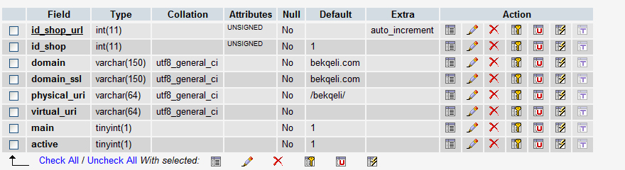

myedinu Posted May 24, 2013 Author Share Posted May 24, 2013 (edited) I've made these changes: attach: Edited May 24, 2013 by myedinu (see edit history) Link to comment Share on other sites More sharing options...
SmartDataSoft Posted May 24, 2013 Share Posted May 24, 2013 attach: no attachment comes Link to comment Share on other sites More sharing options...
myedinu Posted May 24, 2013 Author Share Posted May 24, 2013 And now can you see it? Link to comment Share on other sites More sharing options...
SmartDataSoft Posted May 24, 2013 Share Posted May 24, 2013 And now can you see it? you give the filed name please show me filed data value Link to comment Share on other sites More sharing options...
myedinu Posted May 24, 2013 Author Share Posted May 24, 2013 Thanks, Smartdatasoft I was updating wrong at my phpmyadmin. Now it works! Thank you very much, and I will mark this post as solved Link to comment Share on other sites More sharing options...
