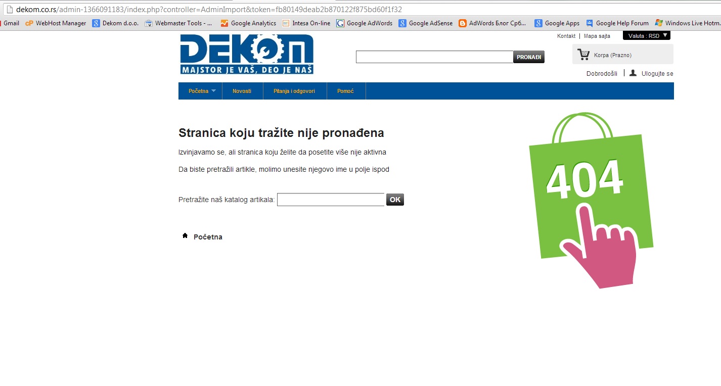

Ok here is the issue.
I prepared CSV file with my products. It has around 1900 entries.
In the middle of the import process, something happens and it redirect me to some unknown page on the front end. No warnings, errors noting...
When I go back to my back office I find that around 100+ products are imported and rest is not.
I tried this several times, sometimes I get 170 products, some times 220 etc...
I contacted my hosting provided and they confirmed that all is good at their end.
What is wrong?

So, after I press import button process begins and it takes usually around 5 minutes.
After that I'm transferred to page on my front end that doesn't exist instead to be taken into back end and showed errors and warnings.

What is happening is your server is timing out on the php execution. When it does, it send you to that 404 page. You need to raise the execution time for you php files by editing your php.ini file if your server allows. I would set it at around 20 -30 minutes during the import and reduce it after that. One problem you might run into is that it will still throw the 404 page after 10 minutes, that is because your browser will only spend 10 minutes loading a page. But if everything i done correctly, you can go to your catalog and refresh it and notice that products are still being added as the script is still running.
edit:
Also, if your sever does not let you change the execution time, just break your csv up into 3 different files and load them one at a time. 1900 products, say do 650 in each file and everything should work fine.
  • Like 2

How long does it take before you see the 404 page? It should be about 10 minutes. See the way a php.ini works is that not all hosts will let you override all values. If the webpage is not loading for something like 10 minutes, it means they are not letting you override the execution limit. Can you send me a pm with the location of your info.php file.

Is it CPU, is it memory limit, someother...?
P.S. What I heard and learned from the Hostgator.com so far is that their VPS is designed to use as a testing server environment and not a real solution for hosting websites. Also their shared servers are much more powerful machines then VPS. Also Prestashop doesn't work ok with their VPS (I went all up to level 5 VPS).
This particular import problem doesn't work on the shared hosting as well as on their VPS, but on the VPS some other issues appear that are not present on the shared environment probably due to more powerful servers.
Error log on the server is showing errors while I try to import products. This was confirmed to me by Hostgator support agent.
Edited by Dolke (see edit history)

I don't think the 404 or internal server errors can be mitigated. They are not really a problem per se, they are just a product of something taking a long time. Most of the time they are returned because of the loading time limit that a browser will try to load the web site.
the only real way around them would be to change the whole import process to use ajax instead of posting it.
