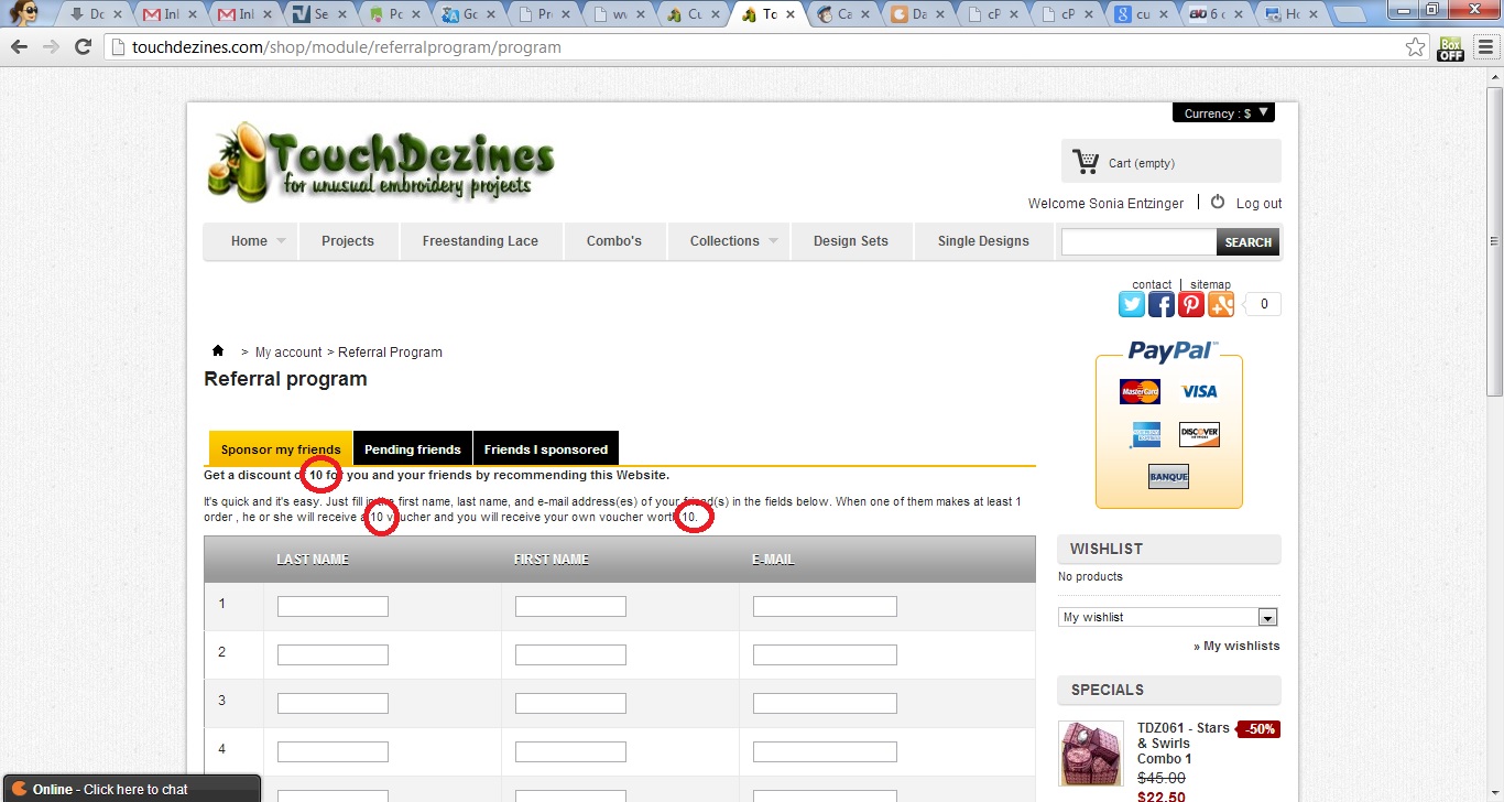

touchdez Posted May 17, 2013 Share Posted May 17, 2013 (edited) The Customer Referral Program does not show a percentage sign in the value, creating the impression that the value (10) indicates a dollar amount instead of percentage (10%). How do I change that so it reads properly? Here is a screenshot: revised Edited May 19, 2013 by touchdez (see edit history) Link to comment Share on other sites More sharing options...

SmartDataSoft Posted May 19, 2013 Share Posted May 19, 2013 Will do - sorry for the delay in answering hello, touchdez i try all the way but not find solution to show 5%. in the tpl file there is no way to trace whether it is fixed referral or percentage referral so you need to edit this tpl and add your 5% sign there. \modules\referralprogram\views\templates\front\program.tpl hope this will solve your issue. if the problem is solved that edit the post title and add [solved] 2 Link to comment Share on other sites More sharing options...
touchdez Posted May 19, 2013 Author Share Posted May 19, 2013 (edited) Good morning, smartdatasoft. I have changed the file you mentioned, but cannot include the % character in the line - line 86: <strong>{l s='Get a discount of %d percent for you and your friends by recommending this Website.' sprintf=$discount mod='referralprogram'}</strong> When I type in the % character, the whole line disappears. I can type in the word percent and it will display, but would still like the character. Is there a way to do this? Edited May 19, 2013 by touchdez (see edit history) Link to comment Share on other sites More sharing options...
touchdez Posted May 19, 2013 Author Share Posted May 19, 2013 smartdatasoft, I think I got it figured out. It is a hex code that had to be included to show the character. Line 86 now reads like this and it shows up correctly on the page: <strong>{l s='Get a discount of %d% for you and your friends by recommending this Website.' sprintf=$discount mod='referralprogram'}</strong> Thank you for your help - it is appreciated! 1 Link to comment Share on other sites More sharing options...

fjesteban Posted August 29, 2013 Share Posted August 29, 2013 (edited) The problem is in the sprintf conversion format. It cast a string into a integer value. To solve the problem just replace %d to %s <strong>{l s='Get a discount of %s for you and your friends by recommending this Website.' sprintf=$discount mod='referralprogram'}</strong> Edited August 29, 2013 by fjesteban (see edit history) 3 Link to comment Share on other sites More sharing options...
