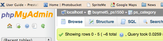

PascalVG Posted September 18, 2013 Share Posted September 18, 2013 Hi geolan, not sure if I understand you right, but do you want to know what to fill in at the database settings page when installing? If so, do this: go to your cPanel, go to phpMyAdmin, login to the database (remember login name and password) and go to your database. Then at the top your see something like this: localhost-><full database name>->selected table so, define('_DB_SERVER_', 'localhost'); (or, if there's something else than localhost in the database line use that) define('_DB_NAME_', '<full database name from above>'); define('_DB_USER_', 'login name'); define('_DB_PASSWD_', 'password'); Hope this helps, pascal 1 Link to comment Share on other sites More sharing options...
