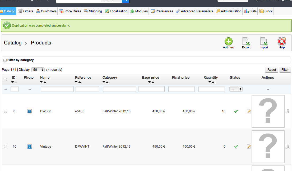

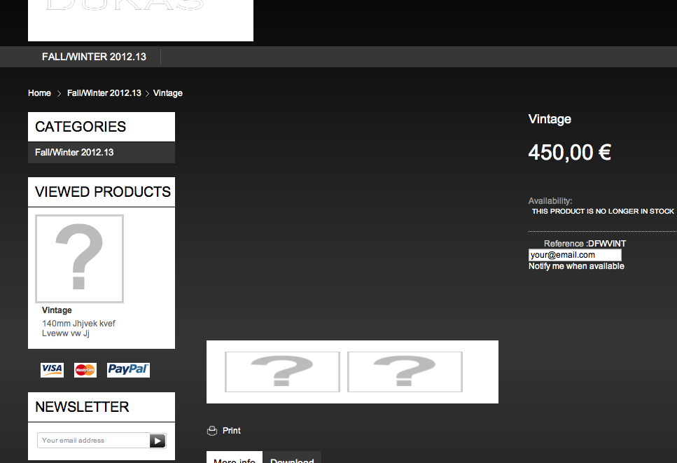

parisk90 Posted May 15, 2013 Share Posted May 15, 2013 (edited) Hello. I am using, for first time, the latest version of PrestaShop and the latest compatible version of a 'bought' theme. I am experiencing issues regarding the Product pictures. Both in the administration panel and the e-shop, I get errors like 'questionmarks' as you can see in the pictures attached below. Why is that? How can I fix this? Regards I also have the 'Friendly URLs' off and in Preferences > Images, they are written as "large_default". Please note, that I have renamed my theme folder to 'default' as well. The shop address is http://www.dukas.com.gr/shop/ Edited May 15, 2013 by parisk90 (see edit history) Link to comment Share on other sites More sharing options...

KSteele Posted June 27, 2013 Share Posted June 27, 2013 (edited) I was having the same issues with Prestashop v1.5.4.1 on a fresh install and could see that the generated image path did NOT match the actual image path and thus the "?" and missing images. I fixed this by disabling "Friendly URL's" and then did a quick search for "Viewed Products Image Missing" to find the fix for the last remaining missing image. The Fix: 1. go to "Preferences" "SEO & URLs" > "Set up URLs" 2. "Friendly URL" select "NO" 3. Refresh your FO page and the images should be back 4. If you do not have root access to your server ask your host to Activate Mod Rewrites and then you may select YES for "Friendly URL" again. (I had this warning: "URL rewriting (mod_rewrite) is not active on your server, or it is not possible to check your server configuration. If you want to use Friendly URLs, you must activate this mod) The "Viewed Products Missing Image" Fix: http://www.prestashop.com/forums/topic/243696-solved-viewed-products-show-question-mark-ps-1541/page__p__1206807__hl__viewed%20products%20image%20missing__fromsearch__1?do=findComment&comment=1206807 Edited June 27, 2013 by KSteele (see edit history) 1 Link to comment Share on other sites More sharing options...
benjamin utterback Posted June 27, 2013 Share Posted June 27, 2013 Hi KSteele, yes you are right. Sometimes Server security settings may not allow PrestaShop to read the server configurations regarding mod_rewrite. It's always important to check with your hosting provider, sometimes that warning may not be accurate. I'll mark this thread as SOLVED. Thanks for the support. Link to comment Share on other sites More sharing options...
