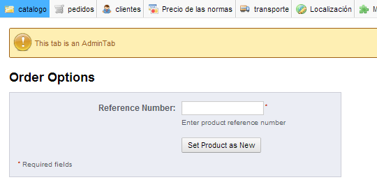

competi2000 Posted May 18, 2013 Share Posted May 18, 2013 I've taken Eck!'s plugin "Order Options" and modified it for setting specific products as new. So, here's how: 1. Copy the attached file into your admin/tabs folder 2. Go to Tools/Tabs/Add New 3. Enter "Set as New" as the name (or whatever..) 4. Enter "AdminSetNew" as the class 5. Select "Catalog" as the parent 6. Click Save 7. Go to Catalog/Set as New 8. Enter the reference number of a product you want to set as new 9. Click "Set Product as New" Tested on 1.5.2 AdminSetNew.php hi idofri. thanks, this is exactly what i was looking for BUT where is the "Tools" menu option that you refer to with "Tools/Tabs/Add New"? i can't seem to find it in my admin cp. i also don't know what the "Order Options" plugin is. do i need to add that in order to see the "Tools" menu option in BO? if so, where can i get the Order Options plugin? thanks, jez... Hola te respondo aquí porque se me da mejor en castellano. El menu "Tools/Tabs" en la version 1.5 es "Administración/Pestañas" El plugin Orden Options del que está hablando idofri es el archivo adjunto que dice que ha modificado y ahora se llama AdminSetNew.php Saludos. 1 Link to comment Share on other sites More sharing options...

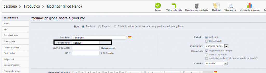

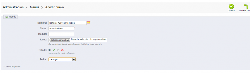

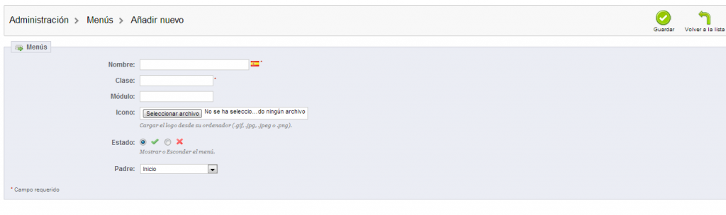

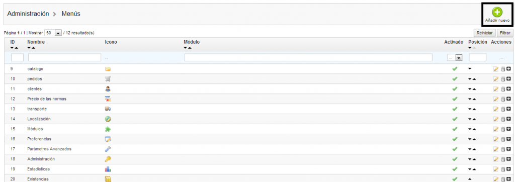

nadie Posted May 18, 2013 Share Posted May 18, 2013 Te lo explico con imágenes y con una guía pasito a pasito. En el mensaje que puse arriba: http://www.prestasho...ost__p__1232118 ¿Te refieres a esto: http://www.prestasho...ost__p__1047574 ? Te descargas este fichero: http://www.prestasho...attach_id=63280 (Recordamos por respeto al autor, que el autor es: idofri ) Lo subes al directorio: /tu_carpeta_de_administracion/tabs/ Hasta aqui facil ¿no? Ahora es cuando adjunto imagenes para que no te pierdas. Pestaña Administración -> Menús Adjunto Imagen Una vez dentro, pulsamos en un icono que dice "Añadir Nuevo" Adjunto Imagen: Y nos aparecerá el siguiente formulario: Nombre: Nombrar nuevos Productos Clase: AdminSetNew Estado: V Padre: catalogo Adjunto Imagen Resumida: Ahora pulsamos en el boton verde superior llamado: Guardar Ahora, si nos vamos a la pestaña Catalogo, veremos la nueva subpestaña. Adjunto Imagen: Si pulsamos sobre la nueva subpestaña "Nombrar nuevos productos", nos llevara al siguiente formulario: Lo que debemos colocar en la casilla de texto, es el numero de referencia del producto que queremos declara como "Nuevo". Numero de referencia no es el id del producto, el numero de referencia, es el numero de referencia que has asignado al editar o crear el producto, en la pestaña Catalogo -> Productos en la pestaña "Información". Adjunto Imagen: 6 Link to comment Share on other sites More sharing options...

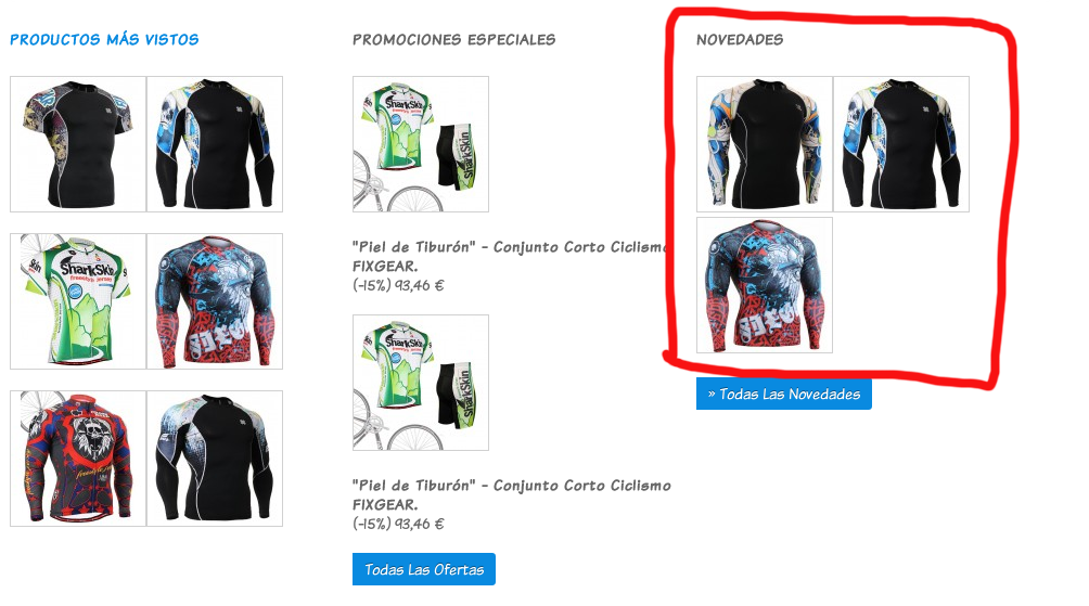

fixgear Posted May 28, 2013 Author Share Posted May 28, 2013 hola ivanchuck, no sé a qué te refieres con el slider de nuevos productos pero al principio pensaba que no aparecían en el bloque de nuevos productos (en mi tienda al pie de las páginas) pero al final sí que me aparecieron. no sé por qué tardaron en aparecer allí per están. véase adjunto newBLOCK.png saludos, jer... Link to comment Share on other sites More sharing options...
