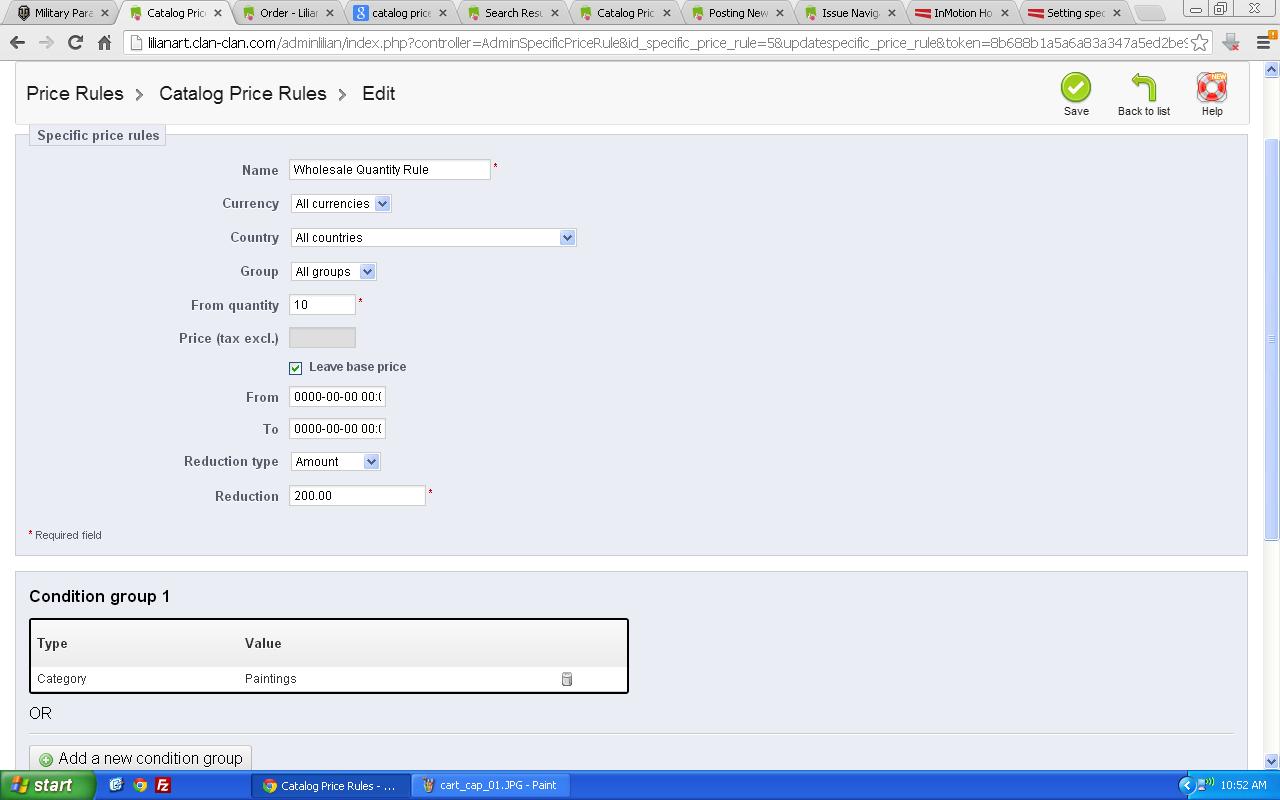

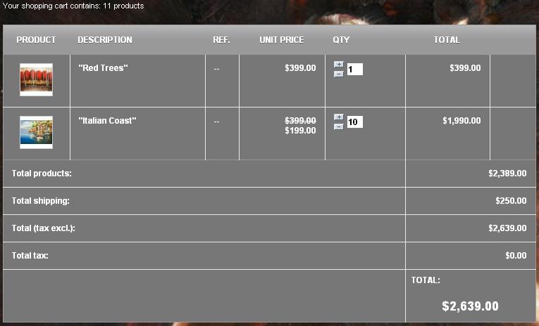

rtulman Posted May 10, 2013 Share Posted May 10, 2013 My apologies in advance if there's already a topic on this, I couldn't find it. I'm running into an issue with Catalog Price Rules in Prestashop 1.5.4.0. I'm trying to apply a simple catalog rule to all of my products in category "paintings". Discount product by $200 if anyone has 10 or more items in my "paintings" category. This works great if I only have 10 or more of one product in my cart, but as soon as I add a different product, the discount isn't applied until the cart has 10 or more of the new product as well. I've attached caps of my cart and rule. The behavior I was expecting was that all items above 10, regardless of product and in the "paintings" category, should be discounted. If you look at the cap of my cart, you'll notice that the single painting (the 11th painting in the cart) should be discounted yet it's not. Did I setup the rule wrong or is this a glitch? Thanks in advance... Link to comment Share on other sites More sharing options...
