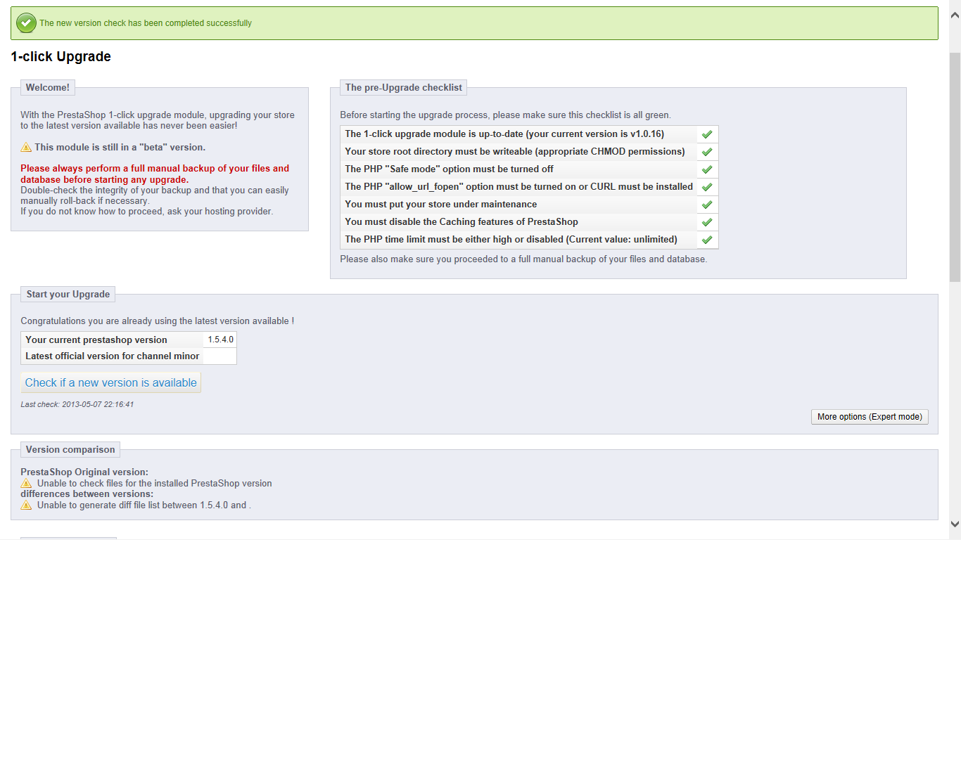

Infinity83 Posted May 7, 2013 Share Posted May 7, 2013 Hi, I am currently running Prestashop 1.5.4.0. On my dashboard, Prestashop advises that there is a new version available - 1.5.4.1 stable. However when I go into the 1-click upgrade module, it says I am already using the latest version available - I have attached a screenshot of this. So I am unable to upgrade. I am not really sure how to do a manual upgrade and would prefer to use this module to perform the upgrade if possible. I have tried uninstalling and reinstalling the module, however that has not worked. Does anybody know what I can do to fix this problem? Thanks. Link to comment Share on other sites More sharing options...
Svelte Design Posted May 20, 2013 Share Posted May 20, 2013 Have you tried going to 'More options (Expert mode) which is bottom right of the 'Start your Upgrade' panel and then changing the release channel search options? It defaults on minor release,try it on major release Link to comment Share on other sites More sharing options...
