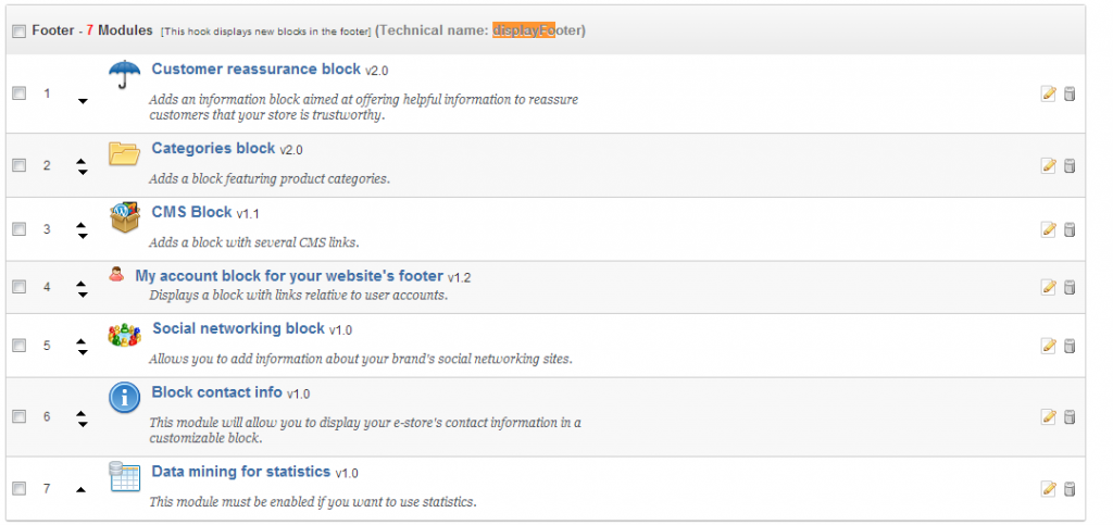

vekia Posted May 3, 2013 Share Posted May 3, 2013 Delete the lite grey line (with the 5 icons) this is reinsurance / reassurance module, go to the modules section, look for this module and disable / uninstall / delete it. Empty the bloc below go to the modules -> positions and remove all modules from footer section. Transform the bloc below in a html bloc, where I can a html code (for advertisment per exemple) use free html block module select footer section in module configuration page and insert own code Link to comment Share on other sites More sharing options...

nadie Posted May 3, 2013 Share Posted May 3, 2013 go to the modules -> positions and remove all modules from footer section. Attached image (For more compression) Sorry for my English. Link to comment Share on other sites More sharing options...

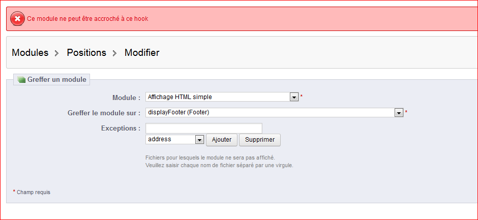

diggy Posted May 3, 2013 Author Share Posted May 3, 2013 Thanks, both of you, your are very clear ! Perfect cooperation ! I just have a problem to put my html block in the footer, why? Link to comment Share on other sites More sharing options...
vekia Posted May 3, 2013 Share Posted May 3, 2013 not that way use module configuration page, you can select hook there: Link to comment Share on other sites More sharing options...

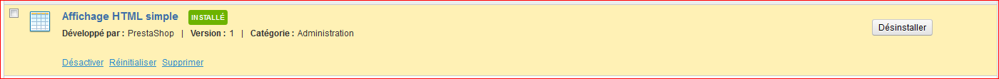

diggy Posted May 3, 2013 Author Share Posted May 3, 2013 I can't configure it. Ist it not the right one? Link to comment Share on other sites More sharing options...
vekia Posted May 3, 2013 Share Posted May 3, 2013 it's not this module ;-) we are taking about this one: http://www.prestashop.com/forums/topic/189039-module-html-box-for-free/ download it and install in your shop Link to comment Share on other sites More sharing options...

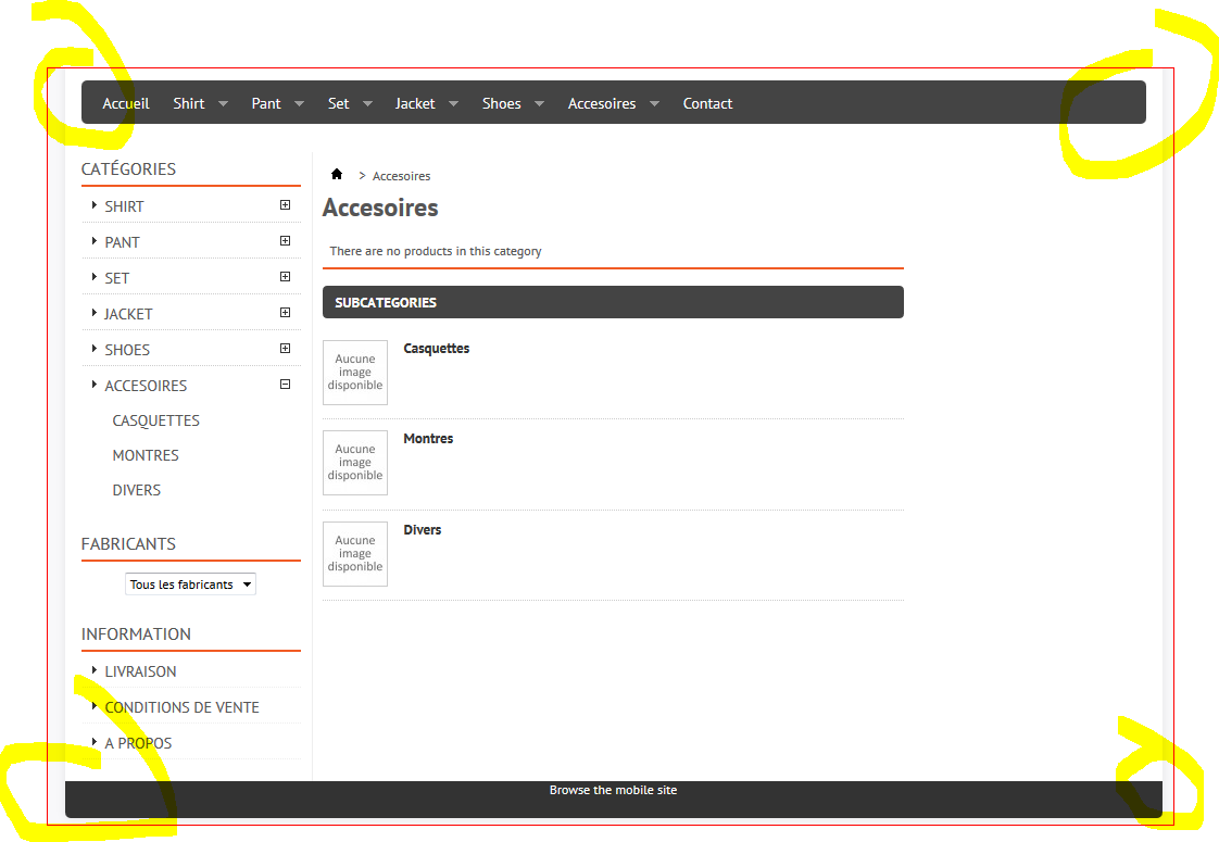

diggy Posted May 3, 2013 Author Share Posted May 3, 2013 Ok, I will find an other way to put my php code... thanks you so much! Have you an idea what I could do to have the footer bloc with the same design (corner and centered) like the menu (under the header)? Link to comment Share on other sites More sharing options...

diggy Posted May 3, 2013 Author Share Posted May 3, 2013 I just add the LESS-CleanTheme to the basic one. It would be just nicer, if the footer would be the same as the menu (under the header), is it possible? Link to comment Share on other sites More sharing options...

vekia Posted May 3, 2013 Share Posted May 3, 2013 ok i don't know the source of the template, but you should check this: open themes/yourtheme/footer.tpl file then: move the whole div: div class="grid_9 alpha omega clearfix" id="footer"> into the div above: <div class="grid_9 alpha omega clearfix" id="columns"> just paste the #footer div at the end of #columns div then change the class file: themes/default/css/cleantheme.css: #footer { background: none repeat scroll 0 0 #333333; color: #FFFFFF; margin: 0 0 0 -15px; width: 1010px; } remove width param and change margin to: margin: 0px auto 10px auto; edit also: #footer { -webkit-border-radius: 0 0 5px 5px; -moz-border-radius: 0 0 5px 5px; border-radius: 0 0 5px 5px; } to: #footer { -webkit-border-radius: 5px; -moz-border-radius: 5px; border-radius: 5px; } final effect: Link to comment Share on other sites More sharing options...
diggy Posted May 3, 2013 Author Share Posted May 3, 2013 Nice, thanks! Only problem, the right side is a little longer that the menu. What do I need to have the same ? Link to comment Share on other sites More sharing options...
vekia Posted May 3, 2013 Share Posted May 3, 2013 hello i checked your page source code and the width: 1010px; still appears there, you have to remove it. then change the class file: themes/default/css/cleantheme.css:#footer { background: none repeat scroll 0 0 #333333; color: #FFFFFF; margin: 0 0 0 -15px; width: 1010px; } remove width param and change margin to: margin: 0px auto 10px auto; Link to comment Share on other sites More sharing options...
diggy Posted May 3, 2013 Author Share Posted May 3, 2013 PERFECT! Thanks you all for your help !!! Link to comment Share on other sites More sharing options...
