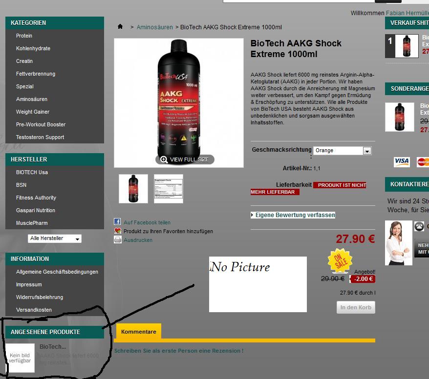

Fabsh Posted April 30, 2013 Share Posted April 30, 2013 Hello guys. My English ist not that good but i dont get an answer at the german board so i hope you can help me with this problem I updated my prestashop from version 1.5.3.1 to version 1.5.4.1. Now i have the problem that modul block viewed dont shows any pictures any more. But with version 1.5.3.1 it worked perfect. Hopefully someone can help me. Link to comment Share on other sites More sharing options...
benjamin utterback Posted April 30, 2013 Share Posted April 30, 2013 Hello, a community member tdr170 has posted a solution about this. Make sure to confirm a working backup and try this in your blockviewed.php "Changing line 108 from this: LEFT JOIN '.DB_PREFIX.'image i ON (i.id_product = p.id_product)'. To this: LEFT JOIN '.DB_PREFIX.'image i ON (i.id_product = p.id_product AND i.cover = 1)'. Fixes the image issue." Link to comment Share on other sites More sharing options...
Fabsh Posted April 30, 2013 Author Share Posted April 30, 2013 Hello , i tryed your fix but now there is no box at all anymore Maybe you can look at the attachmet if i did anything wrong! blockviewed.php 1 Link to comment Share on other sites More sharing options...
