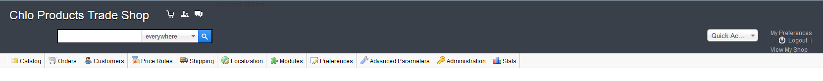

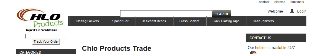

d22009 Posted May 2, 2013 Author Share Posted May 2, 2013 ok this morning i created a copy of my store on my testing server i then ran the manual update following all the advise as the auto update was failing to download. i have a hand full of problems and somthing that appears to be missing so here goes. the store front header is messed up see pic below 2. the admin area header is the same also if you didnt notice on the header the trophy is missing. i have yet to test everything else but i would like to get these style problems resolved asap. Link to comment Share on other sites More sharing options...
Arnel Posted May 2, 2013 Share Posted May 2, 2013 Hello D22009, I took a look at your screenshots, and this is posted as a bug here: http://forge.prestashop.com/browse/PSCFV-8960 They suggest that you change the code in the header.tpl and that the issue is being reviewed. Here's the change based on the post there: yosawan added a comment - 02/May/13 1:29 AM Have to change the setting in header.tpl. It is located in Theme> your theme> header.tpl change </a> <div id="header_right" class="grid_6 omega"> {$HOOK_TOP} </div> to </a> <div id="header_right" class="grid_9 omega"> {$HOOK_TOP} </div> They also give screenshots and it seems to be resembling the same issue you're facing. Try this change and let us know if it helps! Regards! Arnel C. Web Hosting Hub Community Support Team Link to comment Share on other sites More sharing options...
