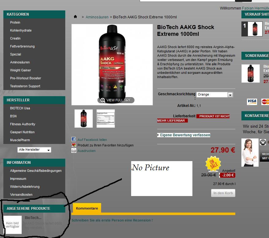

Fabsh Posted May 1, 2013 Share Posted May 1, 2013 (edited) Hello guys , i have the same problem like balutten. I upgraded from 1.5.3.1 to the newest version . I tried the fix from tdr170 but now the modul isnt showing anymore. I really need a solution for this because i want to use the next version. Edited May 1, 2013 by Fabsh (see edit history) Link to comment Share on other sites More sharing options...

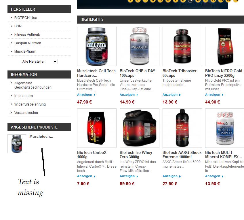

Fabsh Posted May 2, 2013 Share Posted May 2, 2013 Well it nearly worked. You see the picture now but the short description text is missing. Maybe we could fix this too ----- http://test.topsportsfood.eu/index.php I attached a screen and the changed blockviewed.php maybe i changed it wrong. blockviewed.php Link to comment Share on other sites More sharing options...
tdr170 Posted May 2, 2013 Share Posted May 2, 2013 (edited) Edited for content. Edited May 2, 2013 by tdr170 (see edit history) Link to comment Share on other sites More sharing options...
Fabsh Posted May 2, 2013 Share Posted May 2, 2013 Nope i didnt do anything. The text isnt visible when i look at it. I cleaned the cache and used chrome, firefox and the i-net explorer I see that the shop is in english when you visited it. What is strange because only german is activated. Did you tip at the header? Because it links to my original shop at topsportsfood.eu Prestashop 1.5.4.1 is at test.topsportsfood.eu Link to comment Share on other sites More sharing options...
tdr170 Posted May 2, 2013 Share Posted May 2, 2013 Nope i didnt do anything. The text isnt visible when i look at it. I cleaned the cache and used chrome, firefox and the i-net explorer I see that the shop is in english when you visited it. What is strange because only german is activated. Did you tip at the header? Because it links to my original shop at topsportsfood.eu Prestashop 1.5.4.1 is at test.topsportsfood.eu Yes now that you mention it I did just checked and you correct the Short desc does not show. If you change the file back do you get the short desc. but not the image. Link to comment Share on other sites More sharing options...
Fabsh Posted May 3, 2013 Share Posted May 3, 2013 Well i changed it back and now the Short Description is back but the image away . http://test.topsportsfood.eu Link to comment Share on other sites More sharing options...
