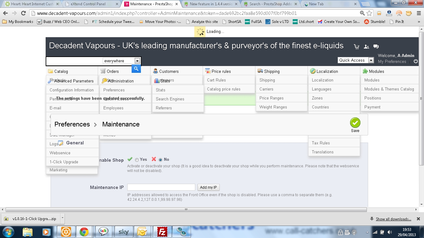

Herbalife Posted April 29, 2013 Share Posted April 29, 2013 (edited) Hi. I've just upgraded to 1.5.4.1 for a client, and the menus on the BO are now extended and overlapping. i had this on my own website a few weeks ago when upgrading 1.5.4, so did a clean install which worked, but I've edited 100's of files within this clients' site so can't afford to start afresh. Any suggestions would be greatly appreciated thanks. *Image attached So, I restored the back up I took before the upgrade, and now the site is down completely, with the error "Bad SubDomain SQL query." Please can someone help? Edited April 29, 2013 by Herbalife (see edit history) Link to comment Share on other sites More sharing options...

Herbalife Posted April 29, 2013 Author Share Posted April 29, 2013 Hi Benjamin. I'm sooo pleased to see you here...thank you The BO was as in the thumbnail image above, so > '1 click upgrade' > rollback. Link to comment Share on other sites More sharing options...
