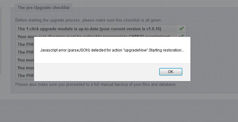

belcoutureco Posted April 28, 2013 Share Posted April 28, 2013 Hi, received this error :Javascript error (parseJSON) detected for action "upgradeNow".Starting restoration" when updating using 1 click anyone can help? thanks! Link to comment Share on other sites More sharing options...

Trad-Archerie Posted May 19, 2013 Share Posted May 19, 2013 same message... PrestaTeam, HELP!! Link to comment Share on other sites More sharing options...

Bill Dalton Posted May 30, 2013 Share Posted May 30, 2013 1-click upgrade' do starts normally, it stops when DB should be updated. hitri, do you receive the same error message? error :Javascript error (parseJSON) detected for action "upgradeNow". Link to comment Share on other sites More sharing options...

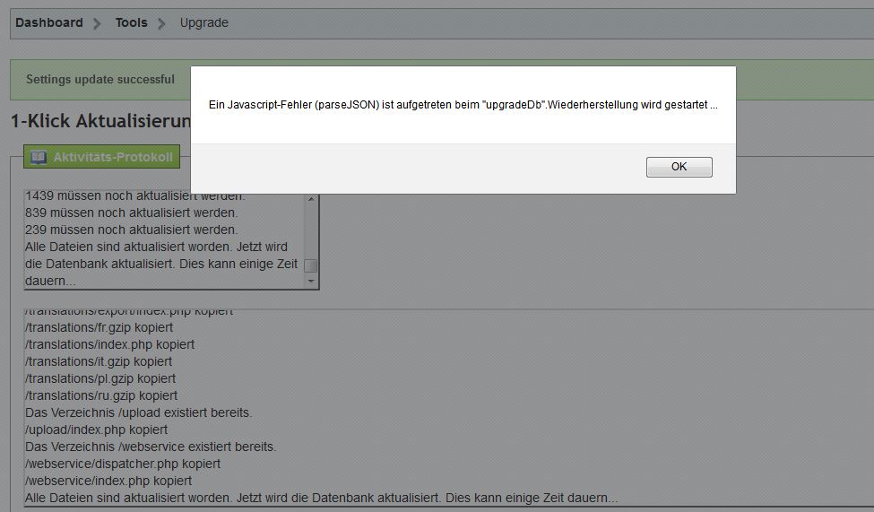

hitri Posted May 30, 2013 Share Posted May 30, 2013 I receive this error: Javascript error (parseJSON) detected for action "upgradeDb".Starting restoration... Link to comment Share on other sites More sharing options...

Alex PSV1.6 Posted July 6, 2013 Share Posted July 6, 2013 (edited) Hi all, I'm faced to the same problem when trieing to perform an update from 1.4.9 to 1.5.4.1. Also performed different settings and different ways but always the same error message as described above. Any ideas? My Webhosting is: SSD-Webhosting Used WEB: Mozilla Firefox V22.0 The error seems to appear when the update of the database is running. (see screenshot in german). The update of the files was succesful. Edited July 6, 2013 by alm-store.de (see edit history) Link to comment Share on other sites More sharing options...

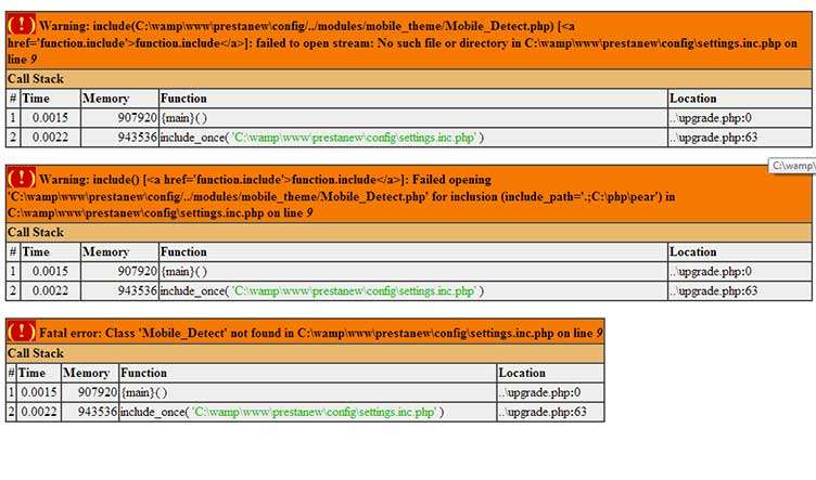

ubergirl Posted July 12, 2013 Share Posted July 12, 2013 (edited) Hi tried a manual update as suggested here: http://www.prestasho...-only-database/ and it doesnt work either, but here is what it says (see also image) ( ! ) Warning: include(C:\wamp\www\prestanew\config/../modules/mobile_theme/Mobile_Detect.php) [<a href='function.include'>function.include</a>]: failed to open stream: No such file or directory in C:\wamp\www\prestanew\config\settings.inc.php on line 9 Call Stack # Time Memory Function Location 1 0.0015 907920 {main}( ) ..\upgrade.php:0 2 0.0022 943536 include_once( 'C:\wamp\www\prestanew\config\settings.inc.php' ) ..\upgrade.php:63 ( ! ) Warning: include() [<a href='function.include'>function.include</a>]: Failed opening 'C:\wamp\www\prestanew\config/../modules/mobile_theme/Mobile_Detect.php' for inclusion (include_path='.;C:\php\pear') in C:\wamp\www\prestanew\config\settings.inc.php on line 9 Call Stack # Time Memory Function Location 1 0.0015 907920 {main}( ) ..\upgrade.php:0 2 0.0022 943536 include_once( 'C:\wamp\www\prestanew\config\settings.inc.php' ) ..\upgrade.php:63 ( ! ) Fatal error: Class 'Mobile_Detect' not found in C:\wamp\www\prestanew\config\settings.inc.php on line 9 Call Stack # Time Memory Function Location 1 0.0015 907920 {main}( ) ..\upgrade.php:0 2 0.0022 943536 include_once( 'C:\wamp\www\prestanew\config\settings.inc.php' ) ..\upgrade.php:63 Edited July 12, 2013 by ubergirl (see edit history) Link to comment Share on other sites More sharing options...
