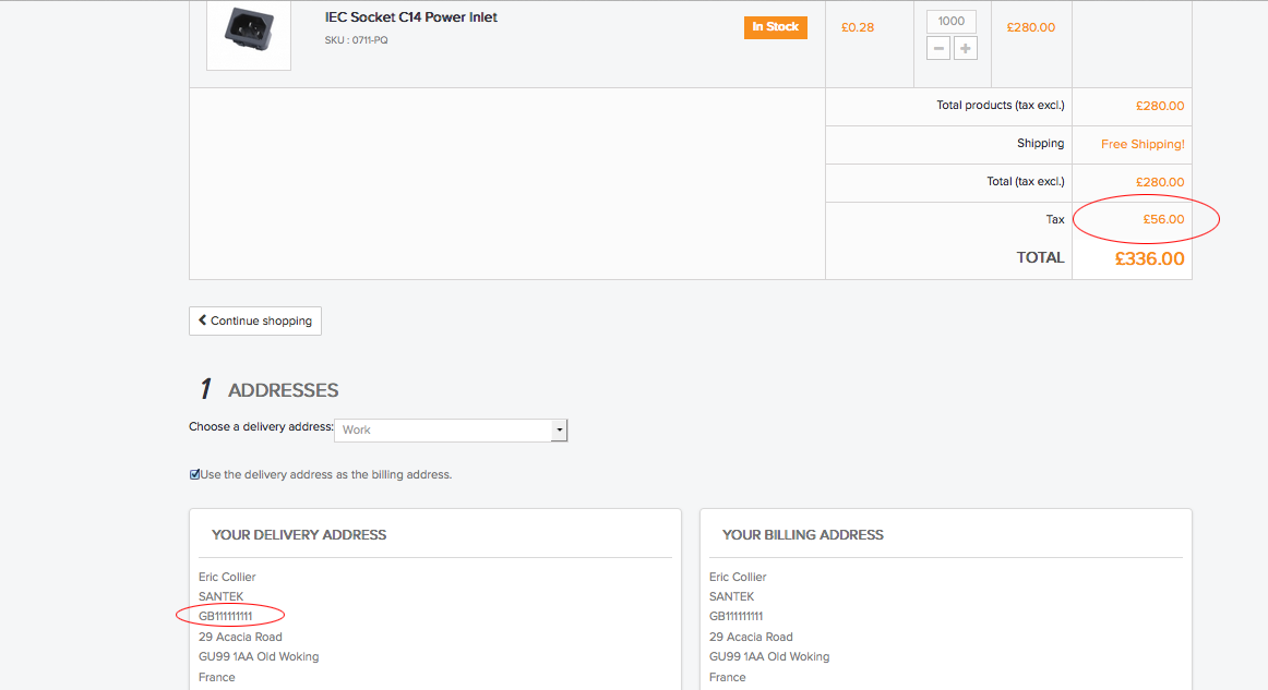

I still have a huge problem with this as all my sales to the EU include VAT and I am loosing a lot of customers (probably!!!) and a lot of time in refunding VAT and explaining this. I am running 1.609 and DO NOT have B2B mode running as this seems to make no difference apart from asking all customers in every country for their SIRET and APE numbers. Basically when a customer enters any format entry in the tax field, according to my understanding this should remove the VAT from the products at the very least. However in my case this is not removed and I can find no way to remove the VAT from these orders.

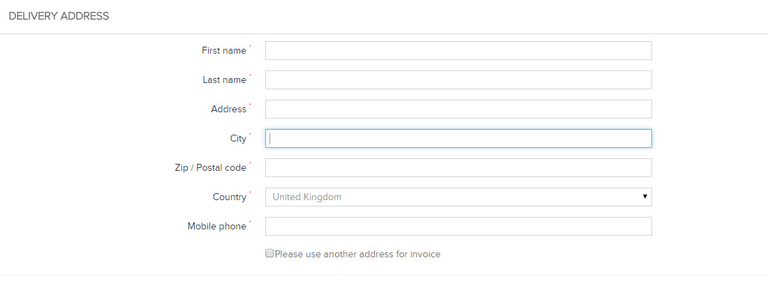

Have you disabled the Company field? Just tried to register and there is no where to put the company details. The VAT number box will only appear after adding the company name
Hi Ron,
I have not disabled, but the VAT number field appears once you enter a company name, so this should be OK as far as I understand. The worked just fine in the earlier 1.4 version I was running, however now we have upgraded to 1.6 this will not remove the VAT!!!

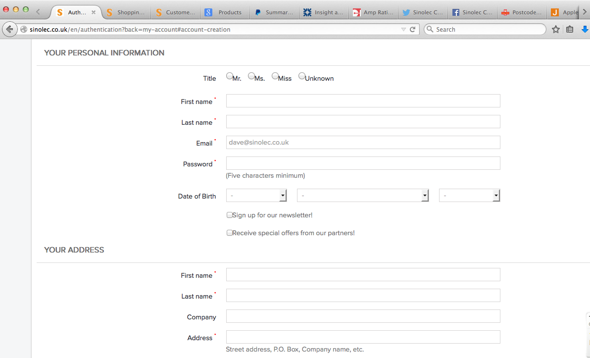

Ah, wait a minute
It does appear if you click register at the top of your page, but not if you check out as guest or create the account from the cart page
So, configuration somewhere. Most customers I think will use the register from the cart, not from the top of the page, so they will not be able to enter their company name and therfore the VAT number gets missed
