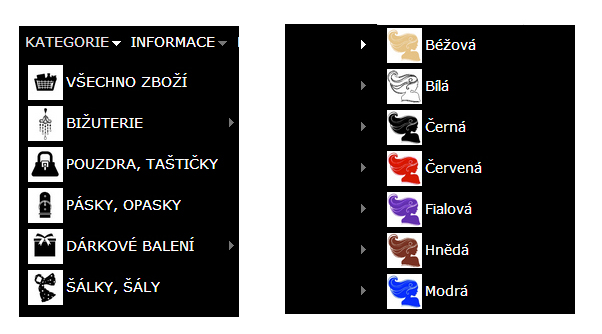

mouse1 Posted September 3, 2013 Share Posted September 3, 2013 Hi guys, thank you for this great code, it works perfectly for me. Would you possibly know how to adjust the code so that it adds a static number at the end of the image name? For example, the code generates pictures called 123.jpg, 124.jpg, 125.jpg and I would like them to be called 123-2.jpg, 124-2.jpg, 125-2.jpg. It's because I need a bit different category and subcategory pictures in top menu from the ones I have everywhere else in the shop (I would, of course, adjust the new pics manually and upload them in the relevant folder). I know it might sound a bit crazy, but I can't find any better solution. Thank you. Link to comment Share on other sites More sharing options...

PascalVG Posted September 3, 2013 Share Posted September 3, 2013 mouse, probably like this: if (!empty($is_intersected)){$this->_menu .= '<li '.$selected.'>';if ($category->id_image != null) // change into this red part$this->_menu .= '<a href="'.$category_link.'">'.' <img src="'._THEME_CAT_DIR_.$category->id_image.'-2.jpg" width="20" height=20"> '.$category->name.'</a>';else$this->_menu .= '<a href="'.$category_link.'">'.$category->name.'</a>';if (count($children))... (Add blue -2 to code above) :-) Explain a little more what you need, maybe there's another way to solve your problem? pascal 1 Link to comment Share on other sites More sharing options...

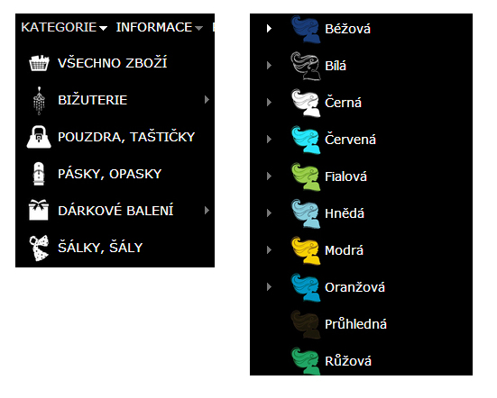

mouse1 Posted September 3, 2013 Share Posted September 3, 2013 Thank you so much PascalVG !! I'm gonna try and explain... I'm also including pics to illustrate. 1) My problem is that I have black and white design. My category and subcategory images are black on white background which is OK. However, my top menu is black, so the font is white and the pictures should also be white... but they are black. :-) Actually they are black with white square background. When I use invert in css, the pics look the way I want, but this doesn't work for me in all browsers. And then another problem comes... problem No. 2 2) When I invert cat and subcat images in css, ALL cat and subcat pictures are inverted, of course, including the ones in my Color category which gives me totally mixed up colors. I can't think of any other solution than adjusting my pics manually (invert the black and white ones and keep the color ones the way they are). Pls see the pics to get a better idea of what I mean. Thank you for your help. Link to comment Share on other sites More sharing options...
PascalVG Posted September 3, 2013 Share Posted September 3, 2013 Mouse do you have a link to your site, so I can play with it a little? (You can PM it to me if you don't want to make it public...) Thx. Link to comment Share on other sites More sharing options...
PascalVG Posted September 3, 2013 Share Posted September 3, 2013 P.S. First quick thought is to make the top menu also white... (maybe with some black border lines to show item blocks, outside border etc.). Is that possible/good idea?? Well, if possible, give me a link. Seeing the real site gives me some full picture... pascal Link to comment Share on other sites More sharing options...
mouse1 Posted September 3, 2013 Share Posted September 3, 2013 P.S. First quick thought is to make the top menu also white... (maybe with some black border lines to show item blocks, outside border etc.). Is that possible/good idea?? Well, if possible, give me a link. Seeing the real site gives me some full picture... pascal Thank you Pascal, I'm grateful for your time and help! White background would not be the solution. :-( I will send you a PM with a link so that you see what the website looks like. Thanks again. Link to comment Share on other sites More sharing options...

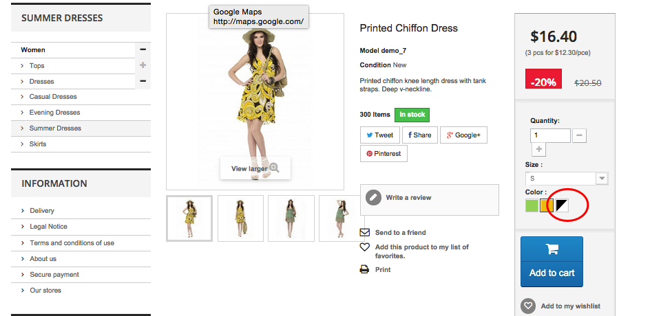

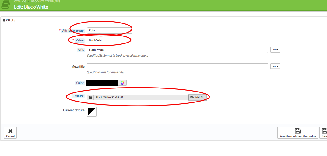

BernardWyatt Posted February 24, 2015 Share Posted February 24, 2015 Hello. I am trying to add colour options to attributes but I need to add a block to show the colour like red or black etc. I am not sure how to add this but I need to go one better. I need to show some colour as Red/White or Black/White and thus want to show a colour block with both colours. Can anyone help me how to do this and please note I am really not handy with any code etc. Link to comment Share on other sites More sharing options...
PascalVG Posted February 24, 2015 Share Posted February 24, 2015 Hi Bernard, Not fully sure if I understand your request well. Do I understand correctly, that you want to add some color attribute to a product, with various dual-tone values, like red/blue, black/white? If so: - Create the attribute, like 'Color' - Add a value - Call the color value something like 'Black/White' - instead of choosing a color from the color palette, you could choose a 'Texture' file, and make some small squares/rectangles graphics (gif/jpg) with both colors, like this: - Choose the graphics file and save - do this for all dual tones you need. Then: - Edit/add a product, and make combinations which use these color values - Go to front page, go to the product, and you will see the combined color shown: Hope this is what you needed. If not, please tell us some more details, and maybe add some quick sketch or so. pascal Link to comment Share on other sites More sharing options...
