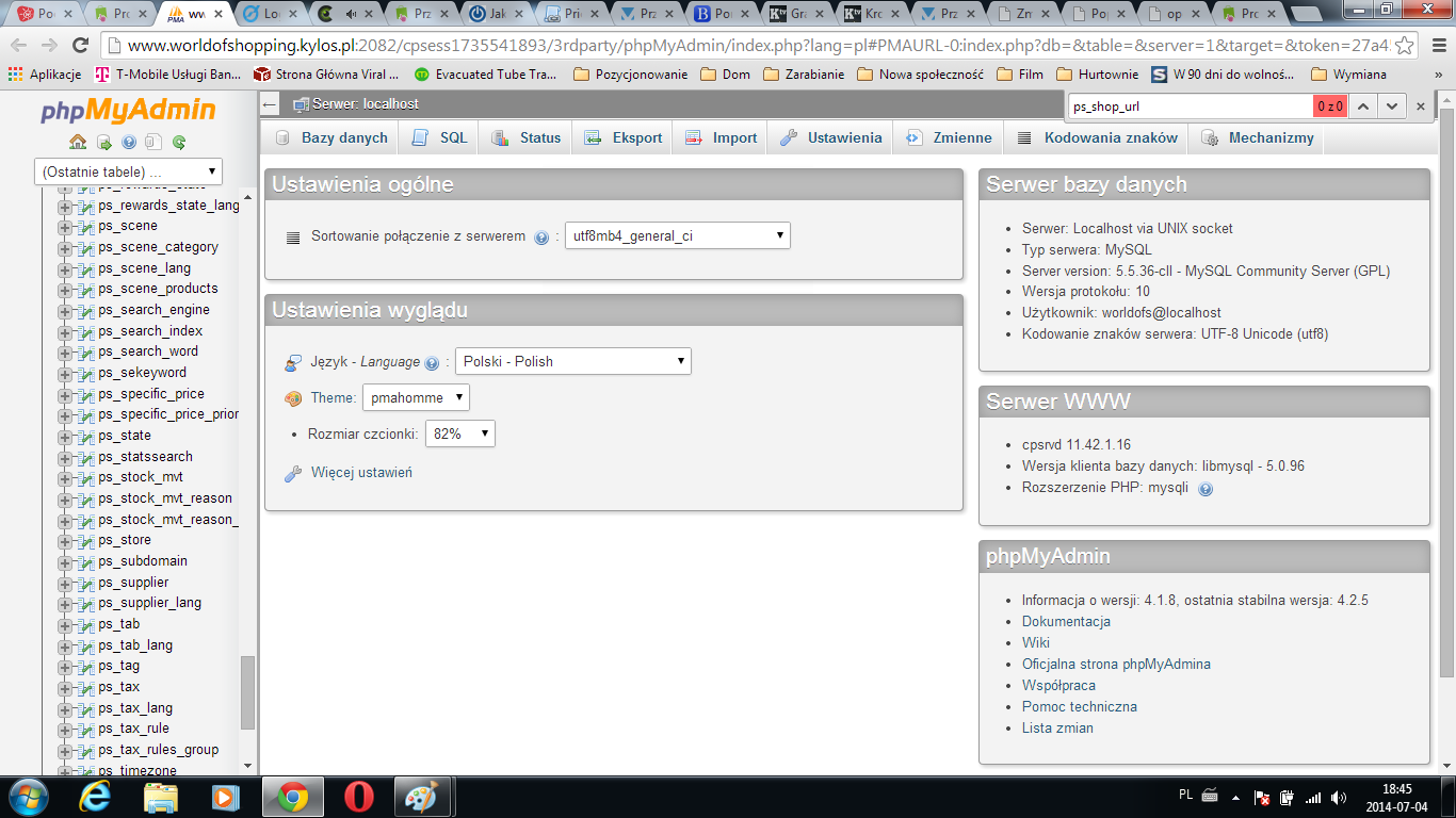

steff86 Posted July 4, 2014 Share Posted July 4, 2014 (edited) i gdzie niby to jest na zdjecie w pliku Edited July 4, 2014 by steff86 (see edit history) Link to comment Share on other sites More sharing options...
endriu107 Posted July 4, 2014 Share Posted July 4, 2014 Teraz doczytałem że to presta 1.4 ona ma w tabeli ps_configuration tabele ps_shop_domain. Link to comment Share on other sites More sharing options...
steff86 Posted July 4, 2014 Share Posted July 4, 2014 jest tam coś takiego PS_SHOP_ENABLE Link to comment Share on other sites More sharing options...
endriu107 Posted July 4, 2014 Share Posted July 4, 2014 Dużo niżej patrz pod pozycją 168 i 169, zapewne na razie jesteś na pierwszej stronie czyli widzisz pozycje od 1 do 30. Link to comment Share on other sites More sharing options...
