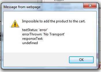

totalfs Posted April 10, 2013 Share Posted April 10, 2013 Hi All, I have finally activated PayPal module and it does come with error when you click add to cart. ## Impossible to add the product to the cart. textStatus: 'error' errorThrown: 'No Transport' responseText: undefined I have disbled/enabled uninstalled / installed several times but still no luck. Please help Attached screenshot Link to comment Share on other sites More sharing options...
benjamin utterback Posted April 10, 2013 Share Posted April 10, 2013 HI, try this,Go to Modules>Cart block>Configure and disable Ajax Cart What is your history with PrestaShop. You started on making your shop on 1.5? 1 Link to comment Share on other sites More sharing options...
totalfs Posted April 10, 2013 Author Share Posted April 10, 2013 It works when you turn Ajax cart off, thank you, but is it possible to make it work with ajax on? I have been playing with Prestashop for years on and off on a small scale but each time you were nearly there something didn't work big time. Like now this thing with Google Checkout, why that is not supported anymore and if it's not why on the main page of Prestashop it say Google Checkout is supported. Someone could make a financial decision by reading this and loose lot's of money. So anyway, this is my last attempt if it will work it's great. If it will be able to process 50 orders per day (doubt it) without blink for next couple of weeks. It will go to production if not I will have to go with different option. 1 Link to comment Share on other sites More sharing options...

benjamin utterback Posted April 10, 2013 Share Posted April 10, 2013 That's cool. Did you import the Bristish English from the Downloaded pack at PrestaShop.com? Disable your Tag's, it's a bug in 1.5.4. Nice site though. Turn Ajax cart back on and I'll go through the checkout process. Also, go to config/defines.php line 28 - Dev Mode to True. Link to comment Share on other sites More sharing options...

benjamin utterback Posted April 10, 2013 Share Posted April 10, 2013 It is not supposed to work by just doing that but hopefully it would give you more information about the error. It should be a javascript issue. Let me check something. Link to comment Share on other sites More sharing options...
benjamin utterback Posted April 10, 2013 Share Posted April 10, 2013 Did you turn the ajax cart back off? Turn it on again. I'll check for any console errors. Link to comment Share on other sites More sharing options...
totalfs Posted April 10, 2013 Author Share Posted April 10, 2013 Hi Mate, While you there can you have a look and try to register as new user? This don't work too. Link to comment Share on other sites More sharing options...
benjamin utterback Posted April 10, 2013 Share Posted April 10, 2013 Yes, you have a jquery error. Was this the template you had at 1.5.3.1? Link to comment Share on other sites More sharing options...

lobogames Posted April 14, 2013 Share Posted April 14, 2013 to fix the paypal problem i just uninstalled the paypal module 3.4.8 and then i installend version 3.4.7. Link to comment Share on other sites More sharing options...
Troy Posted April 19, 2013 Share Posted April 19, 2013 I had paypal problems using 1.5.4 and I downloaded the paypal from ver 1.4.10 and it works for me. I think its paypal 3.4.5 Link to comment Share on other sites More sharing options...
BoKr Posted June 19, 2013 Share Posted June 19, 2013 Ok, before we run into the same issue since we are working on our 149-154 (1531?!) upgrade: Which is the proper paypal version assuming the errors described above were related to it. Link to comment Share on other sites More sharing options...
