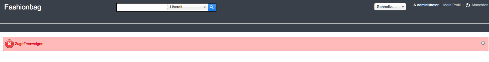

Fashionbag1 Posted April 8, 2013 Share Posted April 8, 2013 After upgrading to 1.5.3. It was working perfect. But on the second day after login i got following message: access denied. Everything is blocked even i login as admin Link to comment Share on other sites More sharing options...

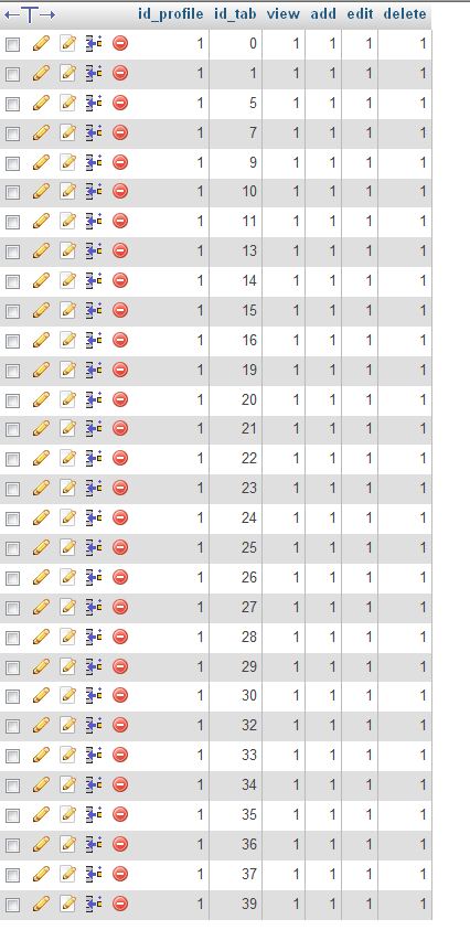

vekia Posted April 9, 2013 Share Posted April 9, 2013 unfortunately I dont see any screenshot. referring to the your first post - image you attached says that something doesnt work with permissions in your store. Check ps_access table, id of your profile should appear there (check my screenshot) your table looks similar? Link to comment Share on other sites More sharing options...
Fashionbag1 Posted April 9, 2013 Author Share Posted April 9, 2013 the screenshot of my access table. Is it normal that you have something like 500 entries there? Thank you Link to comment Share on other sites More sharing options...

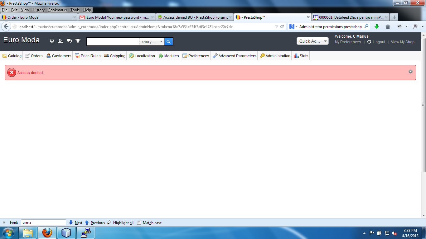

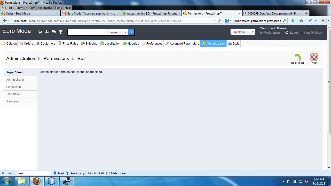

globula_alba Posted April 16, 2013 Share Posted April 16, 2013 I have same problem.In main page BO, Catalog ->Products -> Edit ()->Combination->Product combinations generator and in Administration -> Permissions ->Edit. How resolve that? Link to comment Share on other sites More sharing options...

globula_alba Posted October 6, 2013 Share Posted October 6, 2013 I resolved that problem.The problem is from table ps_access.Tables should look like | id_profile | id_tab | view | add | edit | delete |+------------+--------+------+-----+------+--------+| 1 | 4 | 1 | 1 | 1 | 1 where id_profile is your user id, id_tab is id_tab from ps_tab where class_name='AdminAttributeGenerator'. in my_case: mysql> select id_tab from ps_tab where class_name='AdminAttributeGenerator'; //result is 4 mysql> select * from ps_access where id_tab=4; make update in this table(view=1, add=1, edit=1, delete=1) where id_profile is your id(1 in my case). Wait for response if it worked! Link to comment Share on other sites More sharing options...
