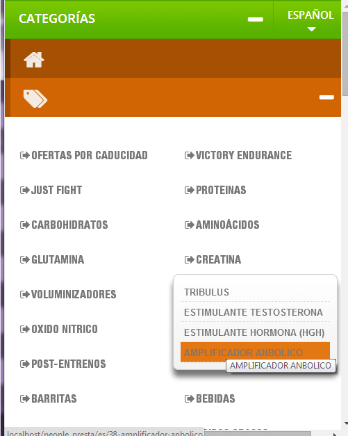

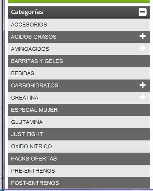

Ron morales Posted May 15, 2014 Share Posted May 15, 2014 (edited) Hi Creacion, Interesting, in my file I have $category and $categories, but no $categorie. do you have a french version of the file somehow? Anyway, anyone who needs this, check if you have one of the two variables and use that one. thanks, creacion! pascal how to show sub-categories with click in buton? in ps 1.6? 1 picture, 2 picture its my web work with hover css but navegation mobile its bad Edited May 15, 2014 by Ron morales (see edit history) Link to comment Share on other sites More sharing options...
