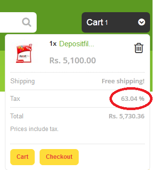

hey i resolved that issue  :) .
i ill put solution below it may help some one.
search this path first :-  Wamp/www/presta1.5/themes/theme799/js/modules/blockcart/ajax-cart.js
In ajax-cart.js
Line no 693:  $('.ajax_cart_tax_cost').text (jsonData.taxCost);
                                Replace above line with following code
                                var subtotal = jsonData.taxCost;
                                var regex = /[+-]?\d+\.\d+/g;
                                var floats = subtotal.match(regex).map(function(v) { return parseFloat(v); });
                                var taxPer=floats/10;
                                $('.ajax_cart_tax_cost').text(taxPer.toFixed(2)+" %");
              but this change is apply at only cart not for shopping cart summary at checkout process.

This helped me and I can confirm it works in Presta v 1.6.1.4. Thank you!
