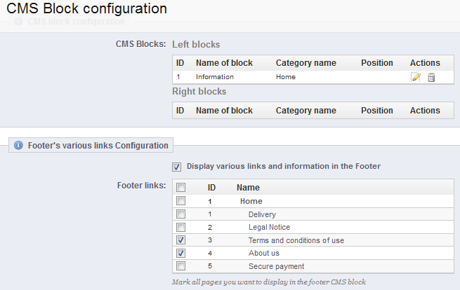

GlennD Posted March 25, 2013 Share Posted March 25, 2013 (edited) Hi all I was wondering if someone might be able to assist me in removing the footer links in the default theme of PS 1.5.3.1 So far I have tried the "solutions" found in the following threads but so far i am struggling to find a solution which works for me: http://www.prestasho...__1#entry777975 http://www.prestasho...lock-in-footer/ and also the one mentioned here at post #2 by tdr170 about modifying modules/blockcms/blockcms.tpl : http://www.prestasho...ooter-cms-menu/ I have looked at the CMS Block Configuration and can see that there are no options available to remove the links i want gone as can be seen in the image below: I have seen mentioned that within CMS Block Configuration there are meant to be left blocks and right blocks, however i can only see left blocks, again with no options for deleting what I want (have I possibly deleted something i shouldn't have here - ie:where is right blocks?) Following is an image of the links in the footer which i would like to remove: For future reference, I would also like to know that if a solution can be reached in this scenario, would the same procedure apply to removing links from other parts of the footer, for example removing the My addresses link under MY ACCOUNT section of the footer. Appreciate any feedback. Edited March 25, 2013 by GlennD (see edit history) Link to comment Share on other sites More sharing options...
