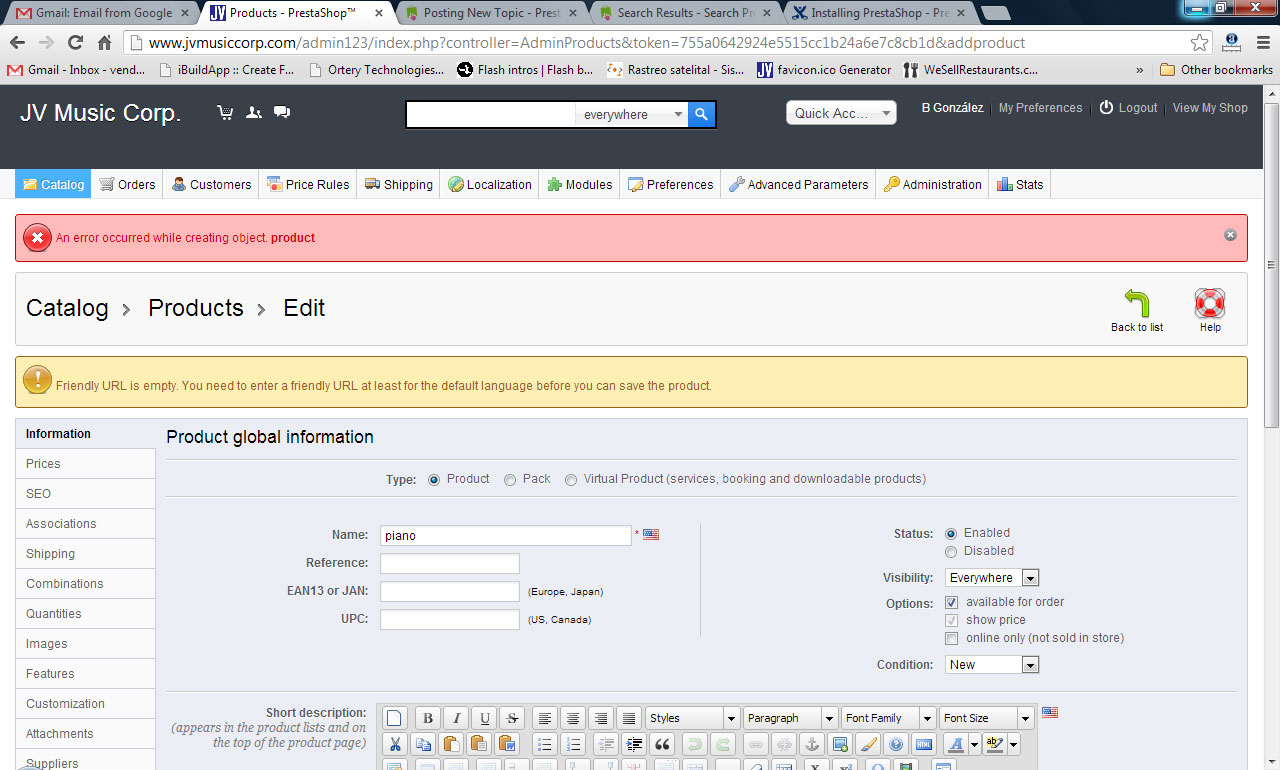

prmag Posted March 23, 2013 Share Posted March 23, 2013 Can't add new products. First it says the product name is empty and I haven't even start typing the product name then after that it says input a friendly url and then it says error saving the product. Can this be a file permission error? I check all permissions on installation and the installer said they where right. But just in case which file permission should be 777 to verify it or is this is another problem? Help My client is waiting for me to start uploading products!!!!!!!!!!!! Link to comment Share on other sites More sharing options...
NemoPS Posted March 23, 2013 Share Posted March 23, 2013 (edited) As a first test, try turning errors on if you haven't done it already. Config/defines.inc.php set PS_MODE_DEV to true ..i should write it in my signature Edited March 23, 2013 by Nemo1 (see edit history) Link to comment Share on other sites More sharing options...

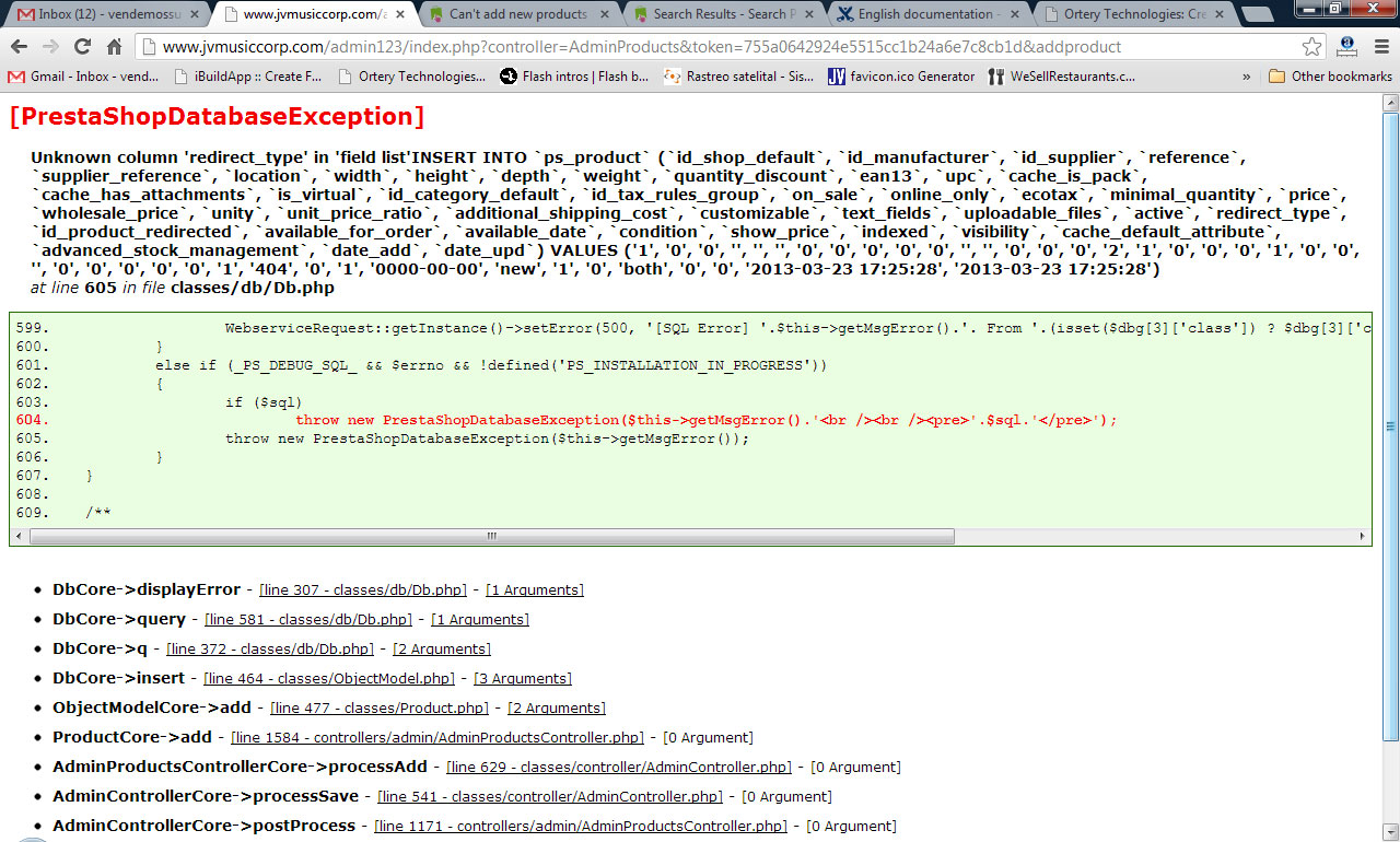

prmag Posted March 23, 2013 Author Share Posted March 23, 2013 THanks. I got this message after changing to true. What should I do now? Don't understand the results. Link to comment Share on other sites More sharing options...
NemoPS Posted March 23, 2013 Share Posted March 23, 2013 Your database is missing that table. Login to phpmyadmin, locate ps_product and add a new fieldwith the following values: name: redirect_type type. enum length/values: '','404','301','302' encoding: utf8_general_ci Link to comment Share on other sites More sharing options...

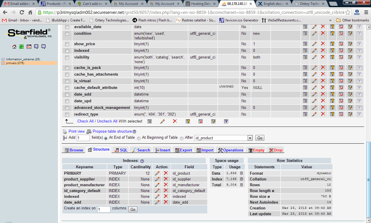

prmag Posted March 23, 2013 Author Share Posted March 23, 2013 I am here but don't know how to add those fields? Link to comment Share on other sites More sharing options...
prmag Posted March 23, 2013 Author Share Posted March 23, 2013 I added the fields but still getting the error. I have included the image for you to review it and check If I did it correct. Thanks Link to comment Share on other sites More sharing options...
NemoPS Posted March 23, 2013 Share Posted March 23, 2013 The very same error? The table's there now, can't be, maybe it's referring to the other db you have? Link to comment Share on other sites More sharing options...
