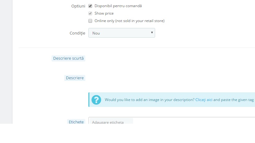

office_axel_company Posted April 6, 2017 Share Posted April 6, 2017 (edited) Hy, I have some problems with showing textarea short description in backoffice. When i want to create new product, in information tab don't apper textarea at short description and description also. I can't share a photo here to see what is my problem. Please tel me where i found the file why i need to change and what i need to change. Best regard, Daniela Edited April 6, 2017 by office_axel_company (see edit history) Link to comment Share on other sites More sharing options...
