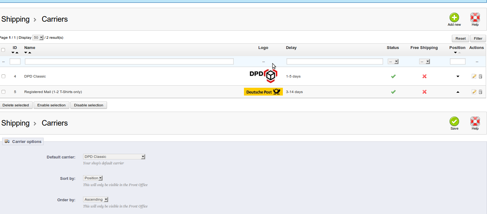

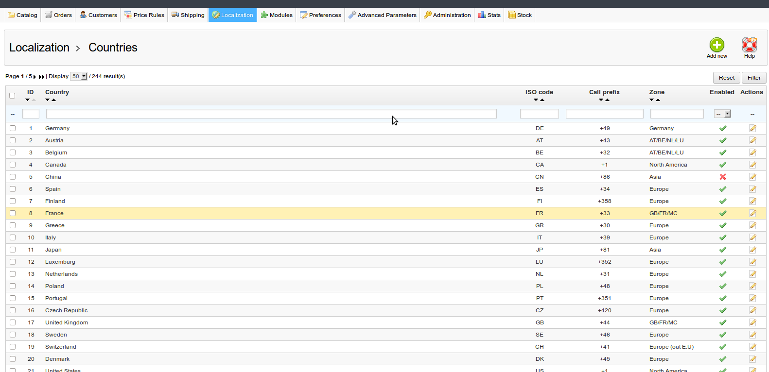

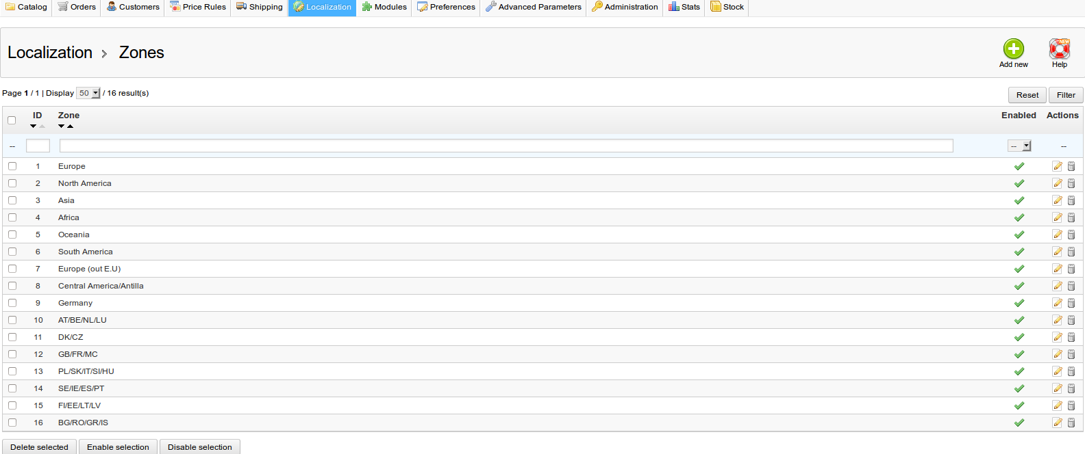

I spent so many hours adding all products and getting the shop ready to go live,
but there is a big problem: shipping does not work
There is no option displayed to select a carrier!
I am attaching screenshots of the settings I did.
Maybe you know what's wrong and where/how I could solve the problem

Hi
I created the products before the carriers.
I went into a product to see , and the carriers are listed but not selected
there is a text saying that if they are not selected, they are all active. and that's how it should be
