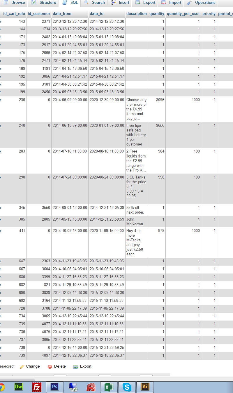

Ray UK Posted January 6, 2015 Share Posted January 6, 2015 Thanks for this by the way... My customers havent been able to use their points for over 1.5 months now due to this I have attached image of sql data because I cant format it correctly for text here Link to comment Share on other sites More sharing options...
jsylvana Posted January 6, 2015 Share Posted January 6, 2015 select the export button at the bottom of the screen and paste the export file. A screen shot is not showing me the entire structure.by way of explanation, the error on primary key is actually on a relationship between two things. 743 is one thing and 1 is the other. That 1 is our problem and finding what it's actually referring to is our goal. 743-1 Link to comment Share on other sites More sharing options...
jsylvana Posted January 6, 2015 Share Posted January 6, 2015 I have to get going for the day, kiddo is done with school. I'm going out on a limb with a guess at the problem. After examining the database structure and noting you are a UK operation I'm going to suggest that you also dump out and post the contents of the tableps_cart_rule_lang It might be quite large in which case the selectionSELECT * FROM ps_cart_rule_lang WHERE id_cart_rule = 743may tell us what we need to know. Do you feel lucky? Link to comment Share on other sites More sharing options...
Ray UK Posted January 6, 2015 Share Posted January 6, 2015 (edited) No worries, and thanks for the help. Yes im uk so its late here now. Ive dumped the contents of that latest sql query, but its not good news I dont think. |------|id_cart_rule|id_lang|name|------|743|1|£29.99 Credit That is the latest Cart Rule that I created today, so I just tried created another few and the code just increases.. So its now An error occurred while creating an object. cart_rule (Duplicate entry '745-1' for key 'PRIMARY') Cheers and hoping you can help more tomorrow Edited January 6, 2015 by MerseyRay (see edit history) Link to comment Share on other sites More sharing options...

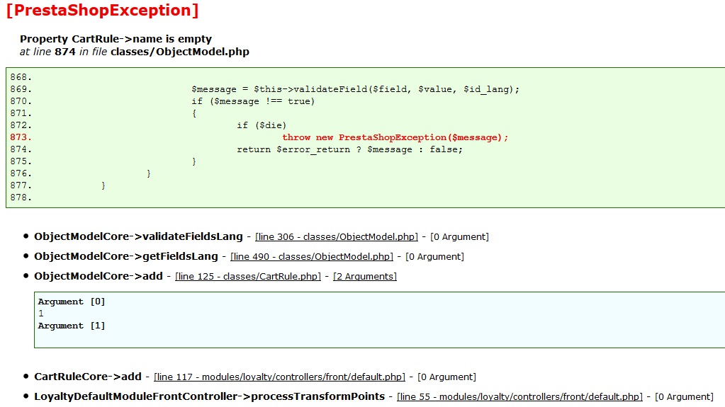

Ray UK Posted January 7, 2015 Share Posted January 7, 2015 Ok, so ive copied the complete site and database to debug it Ive turned debug mode on and get the following error when clicking the "Convert Button" So I went back into the modules B.O and changed the name slightly and clicked save. It shows this error "You must choose at least one category for voucher's action" My categories are already chosen though, and if I reload the module B.O after this error, the categories are still selected. Link to comment Share on other sites More sharing options...
Ray UK Posted January 7, 2015 Share Posted January 7, 2015 Ok, so I have deleted the module v 1.10 via FTP and replaced it with v1.8, and it seems to be working ? Link to comment Share on other sites More sharing options...
