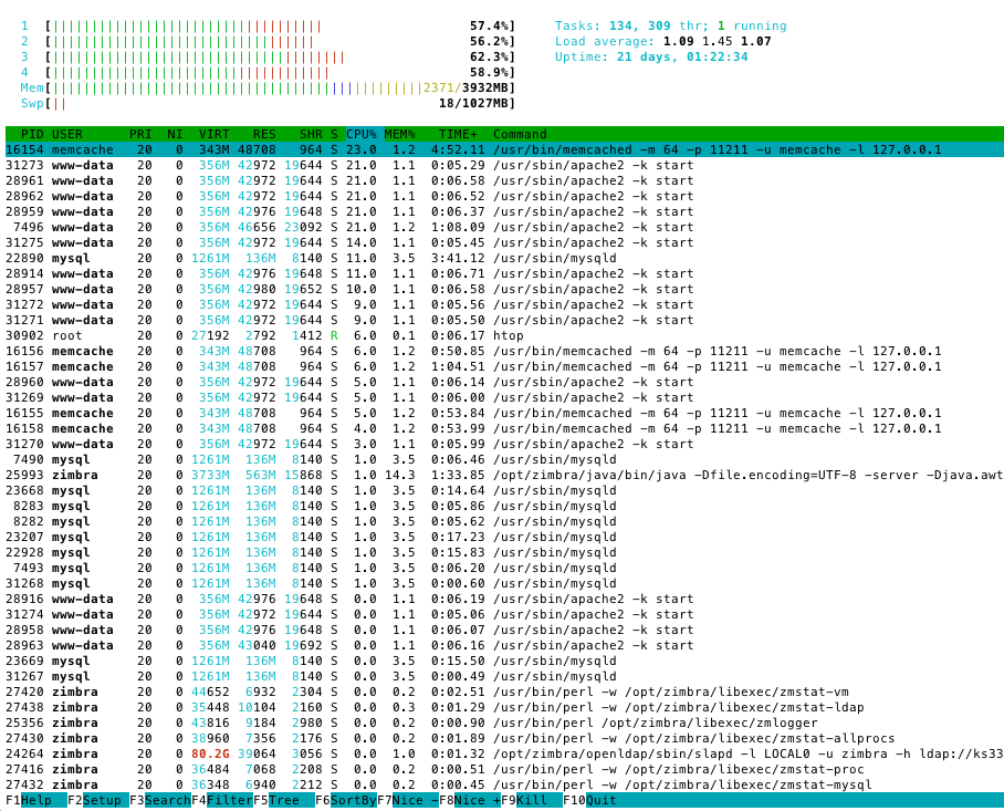

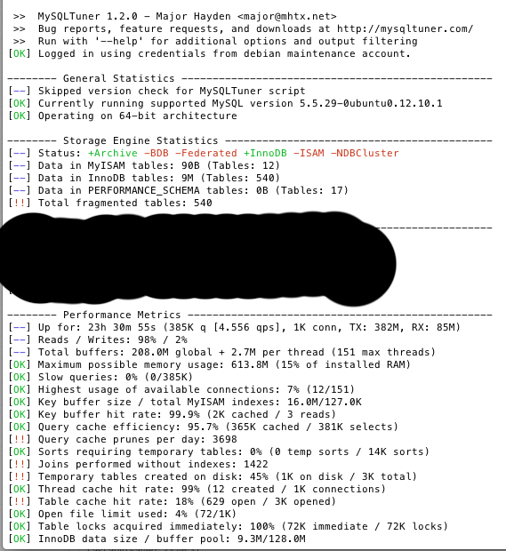

gostbuster Posted March 5, 2013 Share Posted March 5, 2013 (edited) Hi everyone, I posted on the french forum but didn't get any answer, so I'll give a try here, hoping someone as a clue about my issue. Let me explain : My site will be deployed soon but loading times are very very long ! I noticed thanks to this link : http://gtmetrix.com/...gga.fr/BN0iZ7s0 that the time to first byte was the issue. About 6 seconds to get the page displayed. I don't know where to start to get rid of this issue. My prestashop (1.5.3) is installed on a dedicated Kimsufi server (KSR-4G) About my configuration : Au niveau de la configuration: - j'ai évidemment activé le CCC (sauf le css car cela pose des soucis que je n'ai pas réglé) - Le cache smarty est activé, la compilation forcée est désactivé. - J'ai activé le cache memcached - J'ai même crée 3 virtualhosts de cdn comme proposé dans prestashop. - I activated CCC (except for CSS coz I have still some problems with styling) - Smarty cache is enabled, and forced compilation is disabled. - I enabled the memcached cache - I also created 3 virtual hosts (content delivery network) as suggested in prestashop I ran a test for my mysqlServer (on the same machine) (mysqlTuner https://github.com/r...MySQLTuner-perl) Nothing alarming. When I run ab -n 1000 -c 10 http://www.bodegga.fr I don't have a saturated machine (I think) I also installed zimbra on my server so I tried to disable it but no improving with loading times. When I ask the server a simple html page (no mysql request), obviously it works perfectly and it's very fast ! I also enabled mod_deflate and activated gzip compression. I'm wondering how to act to solve this problem. Do you think it's because my server is not strong enough to support prestashop ? Shall I change my server ? If you think at the contrary my host server is quite enought, what shall I check in my configuration in order to solve this ? Thank you in advance for your help ! Edited March 8, 2013 by gostbuster (see edit history) Link to comment Share on other sites More sharing options...
