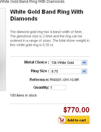

jewelpresta Posted March 5, 2013 Share Posted March 5, 2013 Probably a dumb brain trying to figure out Prestashop but, need some help here. The screen shot will give you an idea of my problem. Have two attributes with values that are applicable for a product. (a) Some values of the first attribute can increase/decrease price. ( Some values of the second attribute can also increase/decrease price. I make a value selection from (a) and the price correctly adds or subtracts the figure that I fed into the setup. However when the same condition is triggered for the second attribute, the price does not calculate based on the increase/decrease parameter. In the screen the price was originally 902$, it dropped correctly to 770$ the moment the Metal choice value was selected. Now when the ring size is selected for the shown value, the price should move up by 50$. It should be 770$ + 50$ = 820$. However it does not show that on the screen. What could I be doing wrong? I have manually created to combinations and not auto generated them. Thanks for any ideas and suggestions that you can provide. JewelPresta Link to comment Share on other sites More sharing options...
tomerg3 Posted March 5, 2013 Share Posted March 5, 2013 Can't really tell anything from that screenshot. You possibly did not create the combinations correctly, a link to the product page would help... Link to comment Share on other sites More sharing options...
jewelpresta Posted March 5, 2013 Author Share Posted March 5, 2013 Hello here is the link to the product. Basically I added the attribute for the metal, then added the next attribute which is the size. The metal does the correct price increase/decrease. The ring size attribute does not. http://www.jewelat.com/shop/birthstone-rings/1-diamond-gold-ring.html#/metal_choice_for_jew-14k_white_gold_jewel/ring_size_selection_-ring_size_7 Thanks in advance for any help that you can provide. JewelPresta Link to comment Share on other sites More sharing options...
tomerg3 Posted March 5, 2013 Share Posted March 5, 2013 You did not create the combinations correctly. Each combination MUST have 1 attribute from EACH group. If you have 2 groups with 5 attributes in each, you should have 25 combinations. Try using the combination generator at the top of the combination tab, it will generate them correctly and quickly. Link to comment Share on other sites More sharing options...
