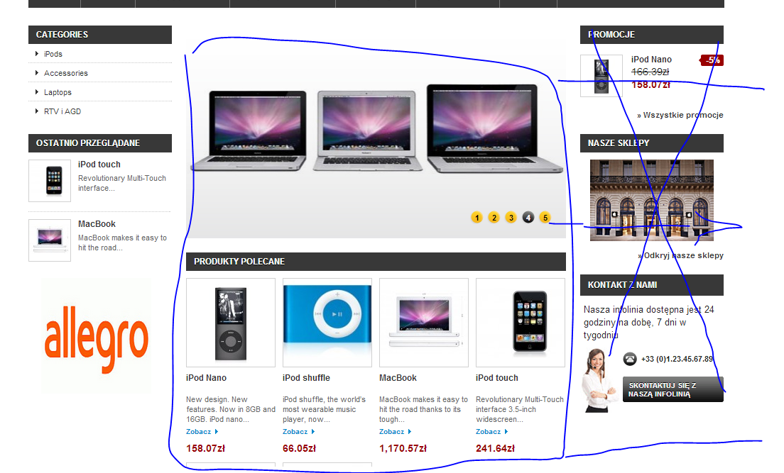

dzordzo Posted March 1, 2013 Share Posted March 1, 2013 Hello, they try to remove the right column prestashop 1.5 in the standard skin, I used a number of instructions that did not work, can I count on your help? Link to comment Share on other sites More sharing options...
NemoPS Posted March 1, 2013 Share Posted March 1, 2013 You can simply remove it (div id="right_column") from footer.tpl in you theme's folder.Then, in header.tpl, set the center column to grid_7 instead of grid_5. Some modules will need to be manually enlarged. Of course, you will need to adjust almost every module/piece that hooks in the center column Link to comment Share on other sites More sharing options...
dzordzo Posted March 1, 2013 Author Share Posted March 1, 2013 I did as you wrote, the central column grid_7 falls down When use a grid 6 too small Link to comment Share on other sites More sharing options...
NemoPS Posted March 2, 2013 Share Posted March 2, 2013 Yes, I forgot to tell you that you also need to add the "omega" class, so that it's like class="grid_7 omega" My bad, sorry! Link to comment Share on other sites More sharing options...
