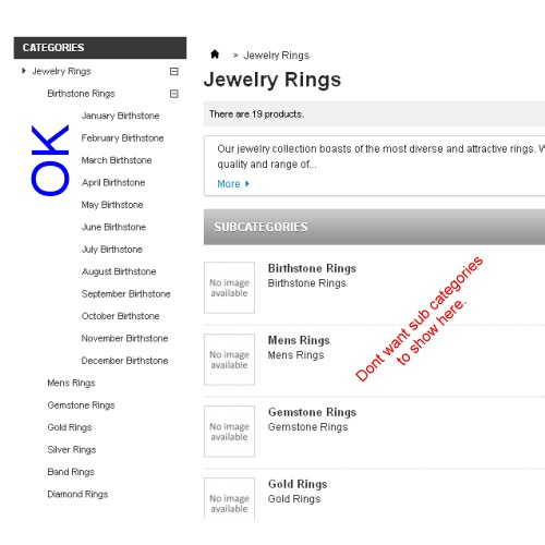

jewelpresta Posted February 25, 2013 Share Posted February 25, 2013 Hello I have installed Prestashop and used the template that came with it. I have a category called Jewelry and sub categories under that. When I click on Jewelry on the left panel, I rightly see a verticle list of sub categories under again in the left panel. But for some reason, the sub categories also show up in the product list portion with icons. I do not want the sub categories to show up there. In the attached image, the place marked OK means that it is fine for the sub cats to appear there. I have put red text in the portion where I do not want the sub categories to show up. Can someone help. Thanks Jewel Presta Link to comment Share on other sites More sharing options...

jewelpresta Posted February 25, 2013 Author Share Posted February 25, 2013 Thanks Alexander I will try that. Also hope that it does not remove the sub category display from the portion on the left panel where it is marked 'OK' in blue. Will update the post with relevant details after that. Thanks Prestajewel Link to comment Share on other sites More sharing options...

jewelpresta Posted February 26, 2013 Author Share Posted February 26, 2013 Ok Thanks, it worked like a dream. Thanks How do we flag this post as - completed or resolved etc? Jewel Presta Link to comment Share on other sites More sharing options...
