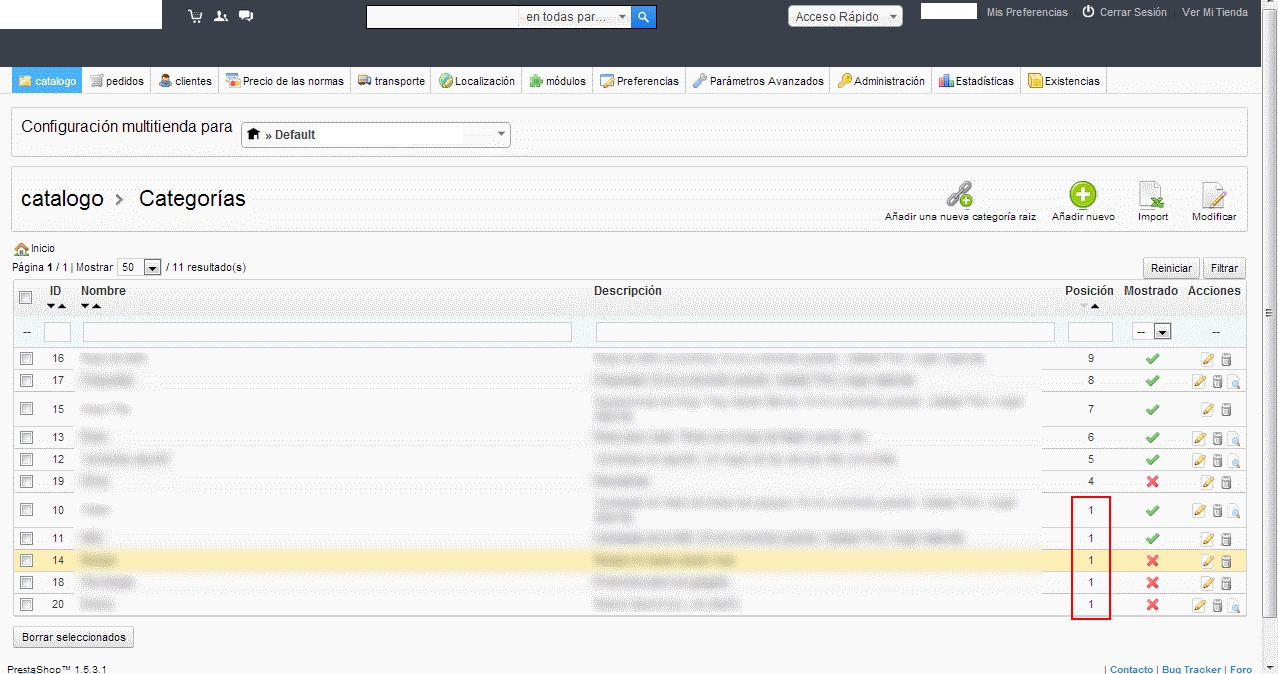

palermuke Posted April 8, 2013 Share Posted April 8, 2013 (edited) Look what problem I have after importing with cvs: The categories don't get import in order. I think this is what causes my problem or at least seems to have a relation. Does anyone know which files are responsible of uploading process? I would like to replace them to check if it solves anything. Edited April 8, 2013 by palermuke (see edit history) Link to comment Share on other sites More sharing options...
