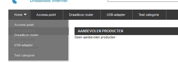

BuB Posted February 18, 2013 Share Posted February 18, 2013 How can I remove the drop down menu with categories from the home link at the top menu? I'm using 1.5.3.1. I do want a home link, but without drop down. Link to comment Share on other sites More sharing options...
Alex Simonchik BelVG Posted February 18, 2013 Share Posted February 18, 2013 Hi, it is simple: just configure module "blocktopmenu" in backoffice Regards Link to comment Share on other sites More sharing options...
BuB Posted February 18, 2013 Author Share Posted February 18, 2013 But I can't find how te remove the drop down menu. I can delete the home button, but that isn't wat I want to do. Link to comment Share on other sites More sharing options...
jpguarin Posted March 26, 2013 Share Posted March 26, 2013 (edited) Remove Home link from "blocktopmenu" in backoffice in configuration. Create a new link at the bottom in spanish is named "Añade un enlace del menú principal" and named it "Home" with the "url" then add that link to the menu in configuration. In PrestaShop™ 1.5.3.1 Edited March 26, 2013 by jpguarin (see edit history) 1 Link to comment Share on other sites More sharing options...
vekia Posted March 26, 2013 Share Posted March 26, 2013 exactly, it is simple and in this case you should remove old menu element and create new with an url to home category Link to comment Share on other sites More sharing options...
