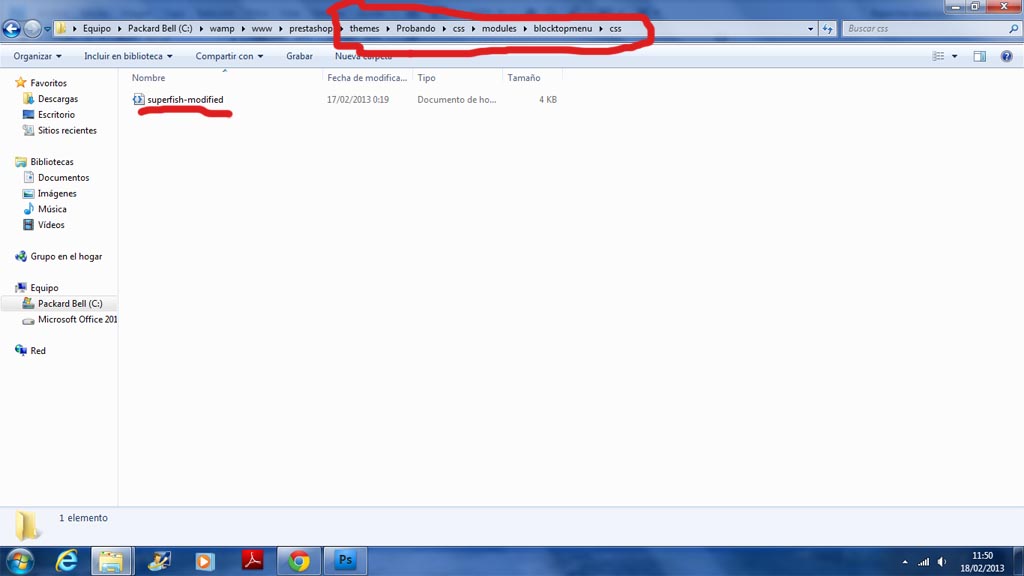

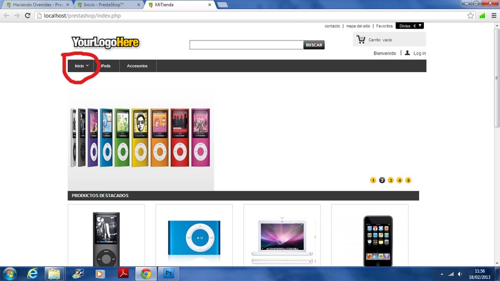

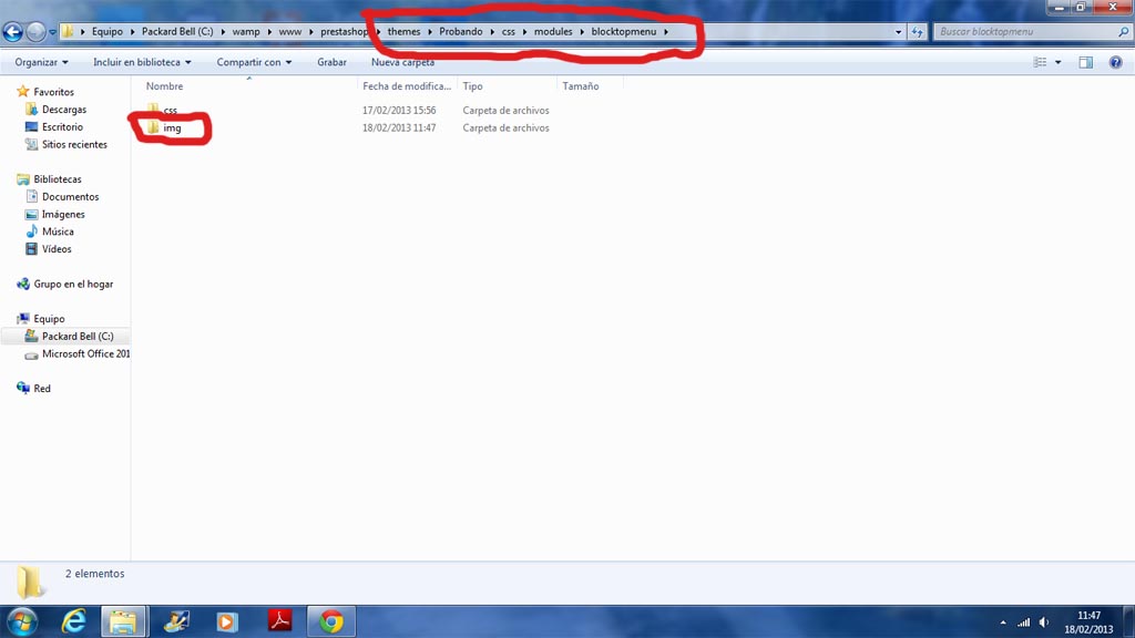

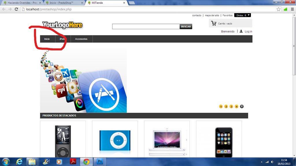

Buben Posted February 18, 2013 Author Share Posted February 18, 2013 Hola de nuevo, Si lo confirmo 100% nadie. Adjunto imagenes. Link to comment Share on other sites More sharing options...
