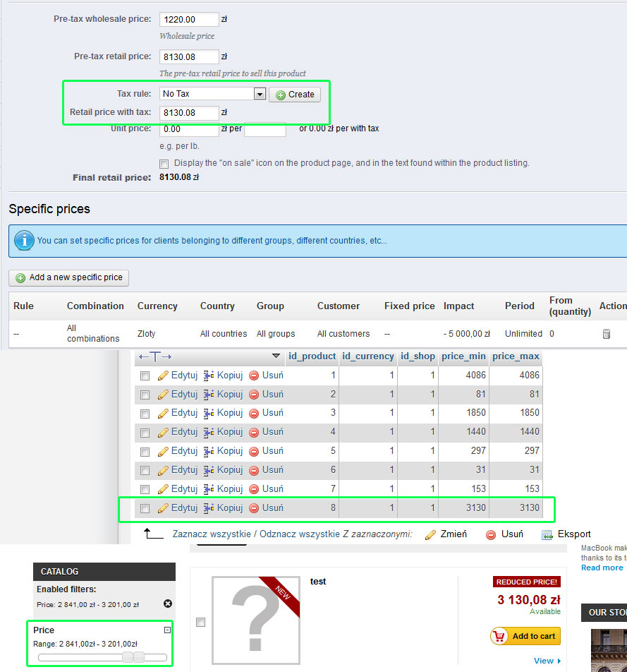

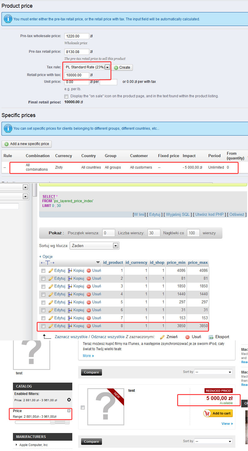

morso Posted July 22, 2013 Share Posted July 22, 2013 Hi Sorry for my english I have a similar problem, but with maximum and mimimum price. I solved problem with minimum price using this: "'.(int)Tools::ps_round($min_price[$currency['id_currency']] * (100 + $max_tax_rate) / 100, 0).',<br>'.(int)Tools::ps_round($max_price[$currency['id_currency']] * (100 + $max_tax_rate) / 100, 0).')';" Big Thanks! But I still have problem with maximum price in table "ps_layered_price_index" The problem occurs only when I use specific price. I'm working on prestashop 1.5.4.1 and blocklayered 1.8.9 (fresh, clean install) I created new product with price 10 000PLN (with 23% tax) and added specific price -5000PLN (PLN - polish currency) I don't know why, but it looks like blocklayered adding 23% tax to specific price 10000 - (5000 + 23%*5000) = 10000 - 6150 = 3850 and it should be 5000 If I turn off tax in product everything works fine I tried delete file "cache/class_index.php and edit line: LEFT JOIN `'._DB_PREFIX_.'tax_rules_group` trg ON (trg.id_tax_rules_group = p.id_tax_rules_group AND p.id_shop = '.(int)$shop_list.') - did not help I'm not turned on multishop Anybody know how to fix this? Link to comment Share on other sites More sharing options...
