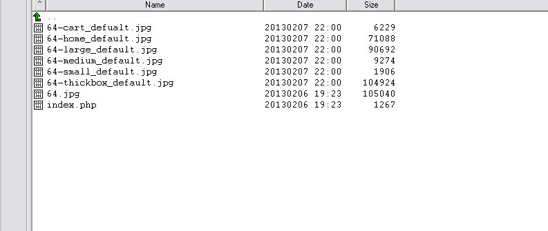

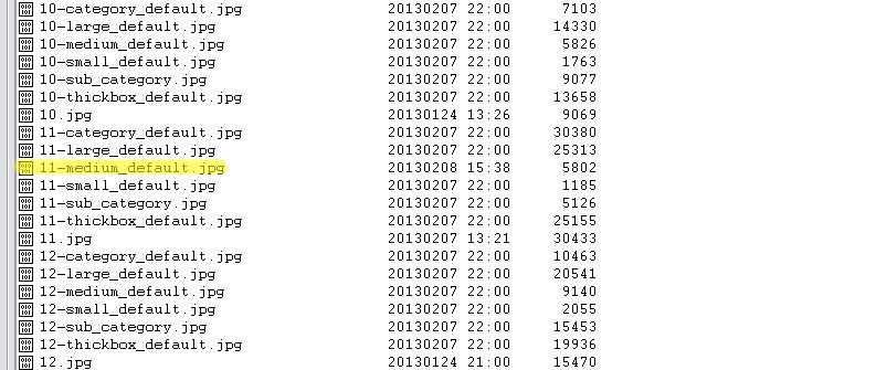

Whispar1 Posted February 8, 2013 Author Share Posted February 8, 2013 (edited) Maybe the light is turning on for me. Attached is a screen of the ftp directory for the pillow category image. The source code for the main category image is this: http://<img src="http://69.36.191.225/img/c/11-category_default.jpg" alt="Pillows & Throws" title="Pillows & Throws" id="categoryImage" width="" height=""> The source code for the same image but on the sub-category page is this: <img src="http://69.36.191.225/img/c/11-medium_default.jpg" alt="" width="" height=""> So I go to my server and pull over 11-medium_default.jpg changed the image and reuploaded it with the same file name. And it works: http://69.36.191.225...roller=category I now have a different, non-scaled image that you can actually see. Is this the correct method for doing this? It is not so bad for the category pics because there are only two instances where they show up and I only have 8-12 sub-categories. However, is this how its done for products too? This seems rather tedious if I have to go in and change each one of them for however many hundreds of products we will be stocking. And while we are on the subject of images (taking the product #64 from the screen shot) The image names are not very SEO friendly. The original image I uploaded in the BO is called duvet-belgravia-white1.jpg but the keywords in the name are not carrying over to the various image versions (64-home_default.jpg , etc...) Additionally, the width/height/alt attributes are not passing through either... why might that be? Edited February 8, 2013 by Whispar1 (see edit history) Link to comment Share on other sites More sharing options...
Bill Dalton Posted February 9, 2013 Share Posted February 9, 2013 Lets use this cat as an example, http://69.36.191.225/index.php?id_category=6&controller=category As you have discovered your category is using medium_default. Go to your Preferences > Images and change the size from 500 x 500 to 150 x 150 then scroll down the page until you see Regenerate thumbnails. You will need to Regenerate your thumbnails. Hopefully that will take care of that. Please let me know. It should end up looking the same, but the images should be the correct size. You may need to clear cache site and browser. Link to comment Share on other sites More sharing options...

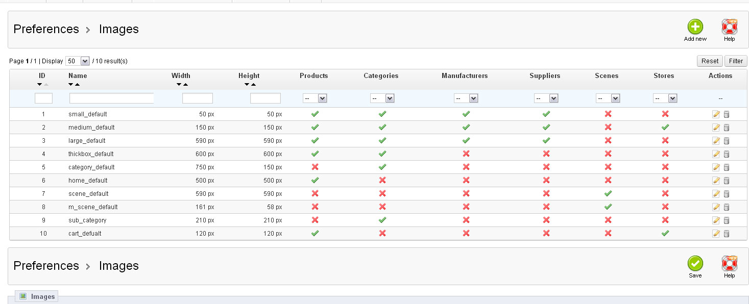

Whispar1 Posted February 9, 2013 Author Share Posted February 9, 2013 Thanks for the help Bill. Here is a screen of my BO The medium_default is already set at 150x150 Defaults shown in the screenie are defaults for the theme. The only one two I changed last week were: medium_default (was 58x58 - changed to 150x150) category_default (was 150x500 - changed to 150x750) I regenerated thumbnails after changing these and cleared my cache. Link to comment Share on other sites More sharing options...
Bill Dalton Posted February 9, 2013 Share Posted February 9, 2013 The images are now the correct 150 x 150. So all is well that ends well. However, this page is using something else, and it is using home_default for its images, http://69.36.191.225/index.php?id_category=7&controller=category Link to comment Share on other sites More sharing options...

Whispar1 Posted February 9, 2013 Author Share Posted February 9, 2013 Bingo - that is exactly what I was trying to say in the beginning - just didn't do a very good job of it. It is useless. That is why I took the 11-medium_default.jpg version of the header image (which what renders on the subcategory page) put a different image in its place, kept the file 11-medium_default.jpg and uploaded that back into the image folder. It worked but after a thumbnail regeneration and cache clear, its now back to the same useless image.... Link to comment Share on other sites More sharing options...
Bill Dalton Posted February 9, 2013 Share Posted February 9, 2013 Yeah, keep a copy of the image file structure on your hard drive, keep only your replaceable images in that. If you ever regenerate thumbnails, you then just need to upload your copy and that quickly and efficiently replaces your custom images. Link to comment Share on other sites More sharing options...
