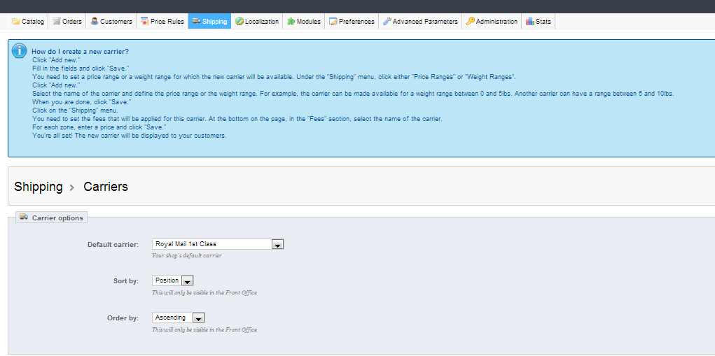

Guest Posted February 3, 2013 Share Posted February 3, 2013 (edited) How strange Just noticed my carrier list is empty The shop works fine, all the carriers are in the front office. If I check weight ranges, they are all listed, if I check Fees by carrier they are all there But in the carrier list in Back office they are gone???? Prestashop 1.5.3 How do I get them back? Edited February 16, 2013 by Guest (see edit history) Link to comment Share on other sites More sharing options...

Guest Posted February 5, 2013 Share Posted February 5, 2013 Thanks for the reply. No the Add button is not there. That whole section is missing. Link to comment Share on other sites More sharing options...

Guest Posted February 6, 2013 Share Posted February 6, 2013 Anyone offer any further thoughts? Can't Add carriers because Add button is missing can;t modify carriers because the carrier list is missing Carrier with tax enabled are not showing tax included Apart from that everything works fine Link to comment Share on other sites More sharing options...

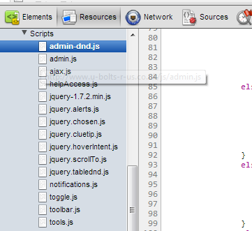

Guest Posted February 6, 2013 Share Posted February 6, 2013 Looks like some .js files are not loading Could this be relevant From a working store from a non working store Link to comment Share on other sites More sharing options...

Guest Posted February 16, 2013 Share Posted February 16, 2013 Still pulling the last few strands of my hair out From what I can tell now using Firebug, these two files are not loading (no error given - so they must not be being called) admin-dnd.js and jquery.tablednd.jds Both files are there and working (as they are used elsewhere OK) so for some reason they are not being asked for on the Carriers page. What I can't find is the code where it should be being loaded Can anyone help with where i can find where these are called from so i can check the code ? Link to comment Share on other sites More sharing options...
