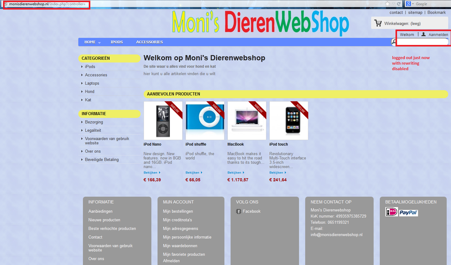

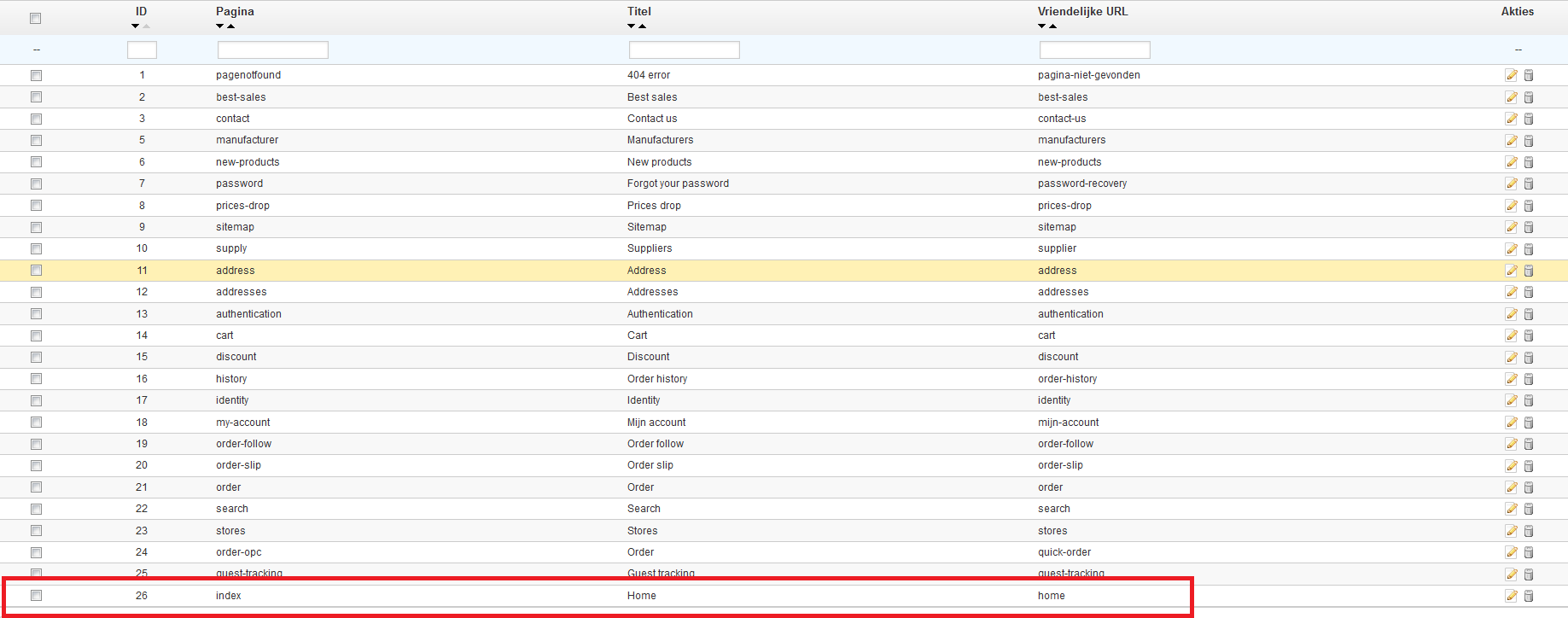

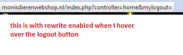

Fadyselim Posted January 31, 2013 Share Posted January 31, 2013 weird enough when i log out of the front end i get to a page showing a 404 error and when i look more closely i notice that the url in the address bar has no controller defined. It started when i had htaccess rewrite enabled and changed the rewrited name of index and deleted all the languages which were not needed. after that i can not get the log out to go to the home page is it is supposed to do... when rewriting is not enabled it logs out and goes to the home screen but then you can actually see that it had no controller. can anybody please help me with this? prestashop version 1.5.2.0 and i have the picture showing some stuff attached to this post. with kind regards, Fady Selim Link to comment Share on other sites More sharing options...
PascalVG Posted February 1, 2013 Share Posted February 1, 2013 Did you regenerate your .htaccess file already? (turn off and then on again the "Friendly URL" option in preferences->SEO- URLs. This will force Prestashop to regenerate the htaccess file) Hope this helps (Succces ermee ;-) ) Pascal Link to comment Share on other sites More sharing options...
Fadyselim Posted February 1, 2013 Author Share Posted February 1, 2013 thanks for th reply but i have tried that and it didn't work for me unfortunely i also tried manually re adding a SEO for index but it didn't fix my problem either.... Link to comment Share on other sites More sharing options...
