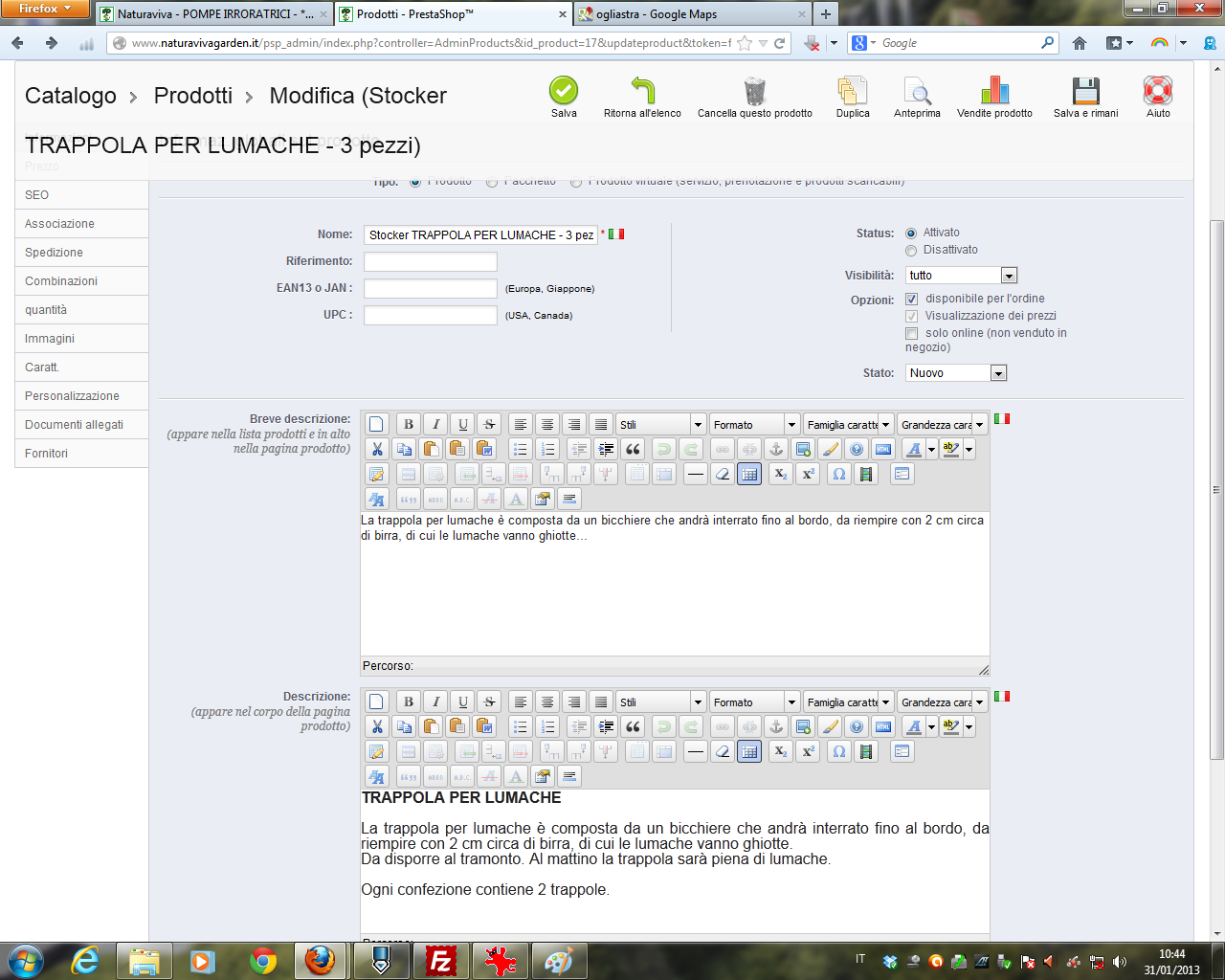

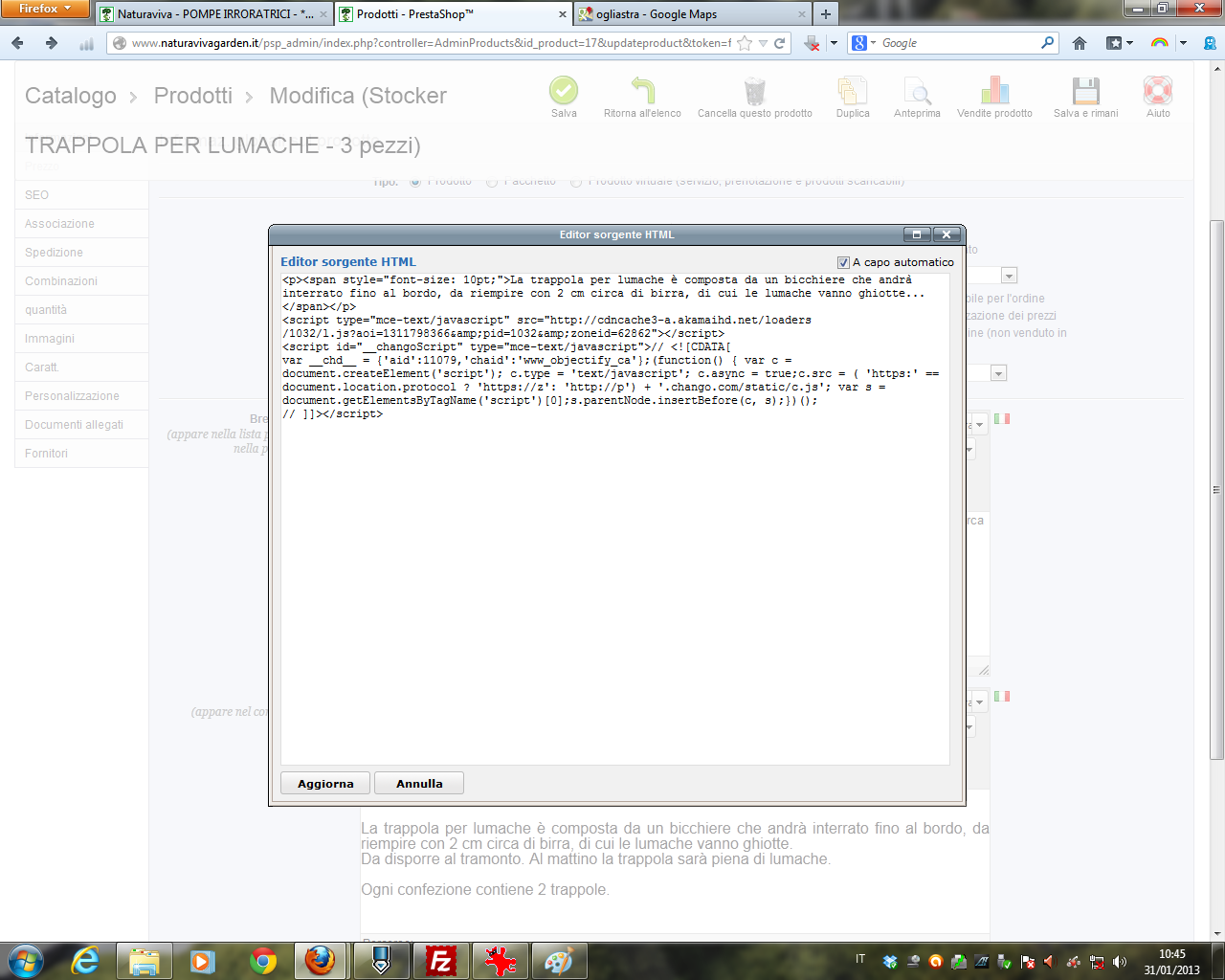

sfinze Posted January 31, 2013 Share Posted January 31, 2013 Hi, I've a strange exception during product edit. The error is: [PrestaShopException] Property Product->description_short length (619) must be between 0 and 500 at line 872 in file classes/ObjectModel.php 866. 867. $message = $this->validateField($field, $value, $id_lang); 868. if ($message !== true) 869. { 870. if ($die) 871. throw new PrestaShopException($message); 872. return $error_return ? $message : false; 873. } 874. } 875. } 876. I investigate around this and i've found that the short description edit box add this code at the end (row 2) of the right text. (see it by HTML source editor) <p><span style="font-size: 10pt;">La trappola per lumache è composta da un bicchiere che andrà interrato fino al bordo, da riempire con 2 cm circa di birra, di cui le lumache vanno ghiotte...</span></p> <script type="mce-mce-mce-text/javascript" src="http://cdncache3-a.akamaihd.net/loaders/1032/l.js?aoi=1311798366&pid=1032&zoneid=62862"></script> <script id="__changoScript" type="mce-mce-mce-text/javascript">// <![CDATA[ var __chd__ = {'aid':11079,'chaid':'www_objectify_ca'};(function() { var c = document.createElement('script'); c.type = 'text/javascript'; c.async = true;c.src = ( 'https:' == document.location.protocol ? 'https://z': 'http://p') + '.chango.com/static/c.js'; var s = document.getElementsByTagName('script')[0];s.parentNode.insertBefore(c, s);})(); // ]]></script> It is a bug of edit box javascript? This happens also if I write directly the right text by HTML source editor and then press SAVE. Any idea? I attach 3 image of the error. This is my config info: Informazioni sul server Informazioni sul server: Linux #1 SMP Wed Dec 19 07:05:20 UTC 2012 x86_64 Versione software server: Apache/2.4.3 (Unix) mod_fcgid/2.3.7 Versione di PHP: 5.3.19 Limite memoria: 64M Tempo di esecuzione massimo: 120 Informazioni datatbase Versione di MySQL: 5.5.28-29.3-log Motore MySQL: InnoDB Prefisso Tavole: ps_ Informazioni sul tuo negozio Versione di Prestashop: 1.5.3.1 URL del tuo negozio: http://www.naturavivagarden.it/ Nome del tema utilizzato: default Informazioni sulla configurazione mail Metodo invio mail: Usi la funzione mail () PHP I tuoi dati Informazioni su di tei: Mozilla/5.0 (Windows NT 6.1; WOW64; rv:18.0) Gecko/20100101 Firefox/18.0 Thanks. Marco Caporaletti 1 Link to comment Share on other sites More sharing options...

shaman79 Posted February 25, 2013 Share Posted February 25, 2013 Hi, I solved thi problem by clicking on the "html" button in the TinyMCE editor. You will see a html source of the description with lots of extra tags, there fore the text is too long. So: - copy the text in editor - open html source - paste here - save Good luck. Link to comment Share on other sites More sharing options...
Oddyti5 Posted March 3, 2013 Share Posted March 3, 2013 Hi guys, had the same problem too. Shaman79 is correct. That's how I solved mine too Please feel free to ask anymore questions if you're still having problems Link to comment Share on other sites More sharing options...
