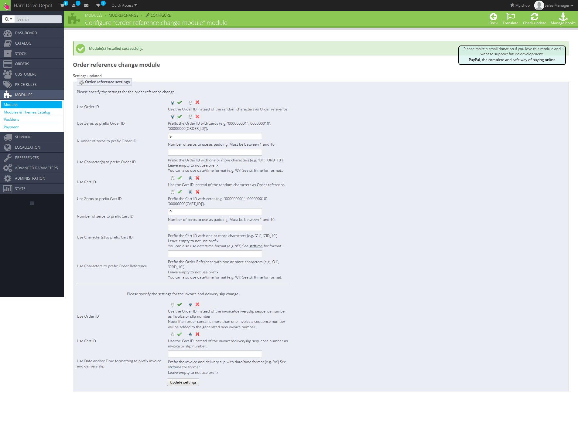

My settings are show on the attached screen shot. I have uninstalled the module and reinstalled with no change.
The module is hooked to these positions:

Ok uncheck top two and bottom two and check the middle two without any number of zeros entered then place an order, once that is done then check the top 2 again, I dont think you should use option for invoice and delivery sequance options in that case you might have issues withc ustomer receiving order confirmation emails without invoice.
Once this is done let me know , I will tell you bit more what needs to be done

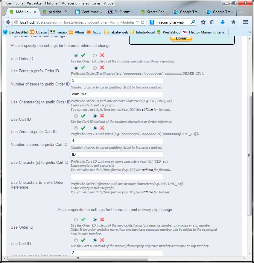

I have a problem when I want to add a text and a date, eg "com_2014_0001" in the field "Use Character (s) to prefix Order ID" put "com_% Y_" but the result is "com_% Y_com_2014_00060". Someone could put me an example?
They attached a picture of the configuration
thank you very much
thank you very much

Step3: delete
Step4: Modules->Add New Module - modrefchange.zip (latest)
Step5: install
Step6: configure
This solves the ID_ORDER, ID_CART not working issue. As mentioned earlier in the threads, 'delete' is the key.
Step7: Extract modrefchange.zip locally
Step8: Open modrefchange.php
Step9: On line #852, 'else' is missing. Add it! If confused, slightly scroll down and look at the pattern from below.
Step10: Do not forget to upload this file to <your_prestashop_website_home>/modules/modrefchange/
This solves the issues of date fields appearing literally. This is also mentioned at post #334 I believe, or wait for an update.
-Manu

Hello,
I have this problem in PS 1.5.2 and this module 1.2:
In e-mail which received customer (Order confirmation - order_conf.html) is new number of order corectly showed ("ORD_0098_0233"). But in e-mail which prestashop send to me as owner - there is only number of order without new options set in module("000098").
In Orders (in Backoffice) is number of orders also in right format, but for me is very important confirmation email sent to owner - I need in this e-mail right format (not only order number ).
I check if translation is set coretly and yes it looks like yes it is:
mails/cs/order_conf.html:
Order: {order_name} created {date}
Payment: {payment}
modules/mailalerts/mails/cs/new_order.html:
Order number: {order_name} created {date}
Payment method: {payment}
Setting of module:
Use Order ID: yes
Use Zeros to prefix Order ID: yes
Number of zeros to prefix Order ID:4
Use Character(s) to prefix Order ID: ORD_
Use Cart ID: yes
Use Zeros to prefix Cart ID:4
What is wrong? Where can be bug?
Problem in mailalerts.php line 392(?):
sprintf(Mail::l('New order - #%06d', $id_lang), $order->id),
I dont know..
Please help.
Thank you!

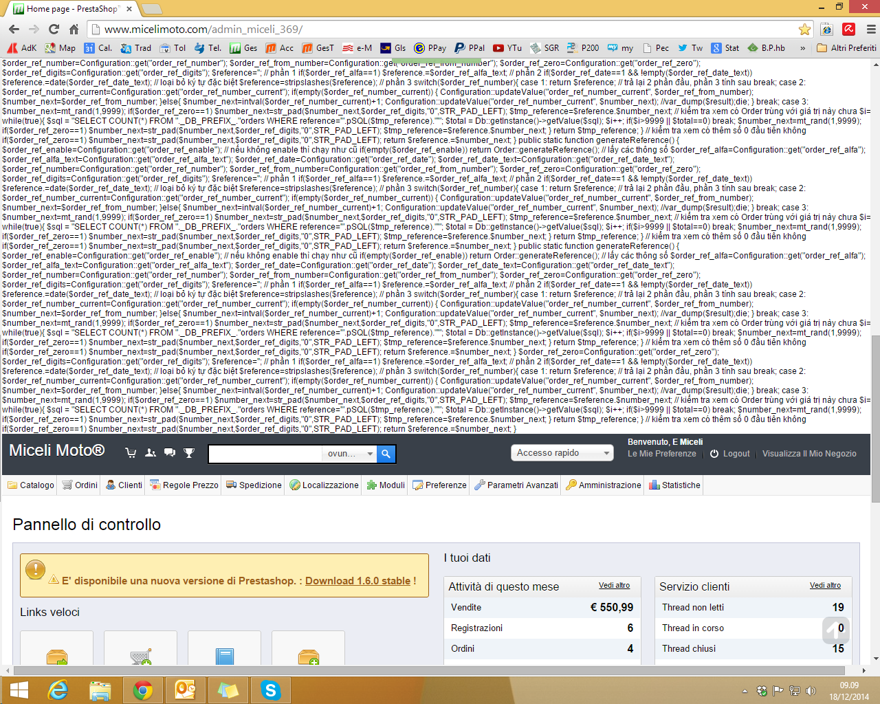

Hi
I have also problem - module work fine - until server was changed. Now - all orders are again AGFDRJKJ numbers. I uninstall and deleted the module - and add it again - but still nothing. Error log is empty. I controlled overrides also cache index - this is rebuild. dev mode doesn't show also any errors. So what else - what to look now?
