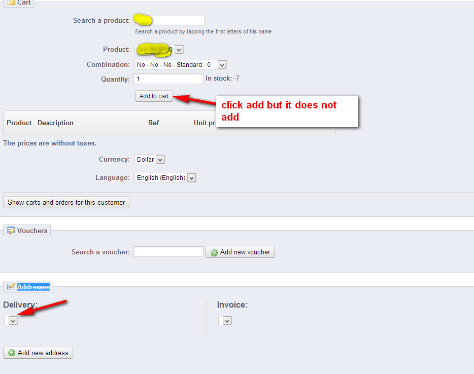

hipeq Posted February 14, 2013 Share Posted February 14, 2013 I have a similar issue except I can not even add a product.. Please see attached... Link to comment Share on other sites More sharing options...
devilsown Posted February 15, 2013 Share Posted February 15, 2013 make sure that you turn on errors, might be an issue with your shipping moduals. Link to comment Share on other sites More sharing options...
hipeq Posted February 15, 2013 Share Posted February 15, 2013 I will do that.... here is additional information.. I used a fresh new database from Prestashop 1.5 install and there were no issues with making new orders from back office. So it looks to me like there are some fields missing in the database, or some conflicts.... Any thoughts? Link to comment Share on other sites More sharing options...
hipeq Posted February 15, 2013 Share Posted February 15, 2013 Here is the solution I have found: delete ps_tab and ps_tab_lang and replace them with tables from Prestashop 1.5 fresh install database.. that fixed it... Link to comment Share on other sites More sharing options...
