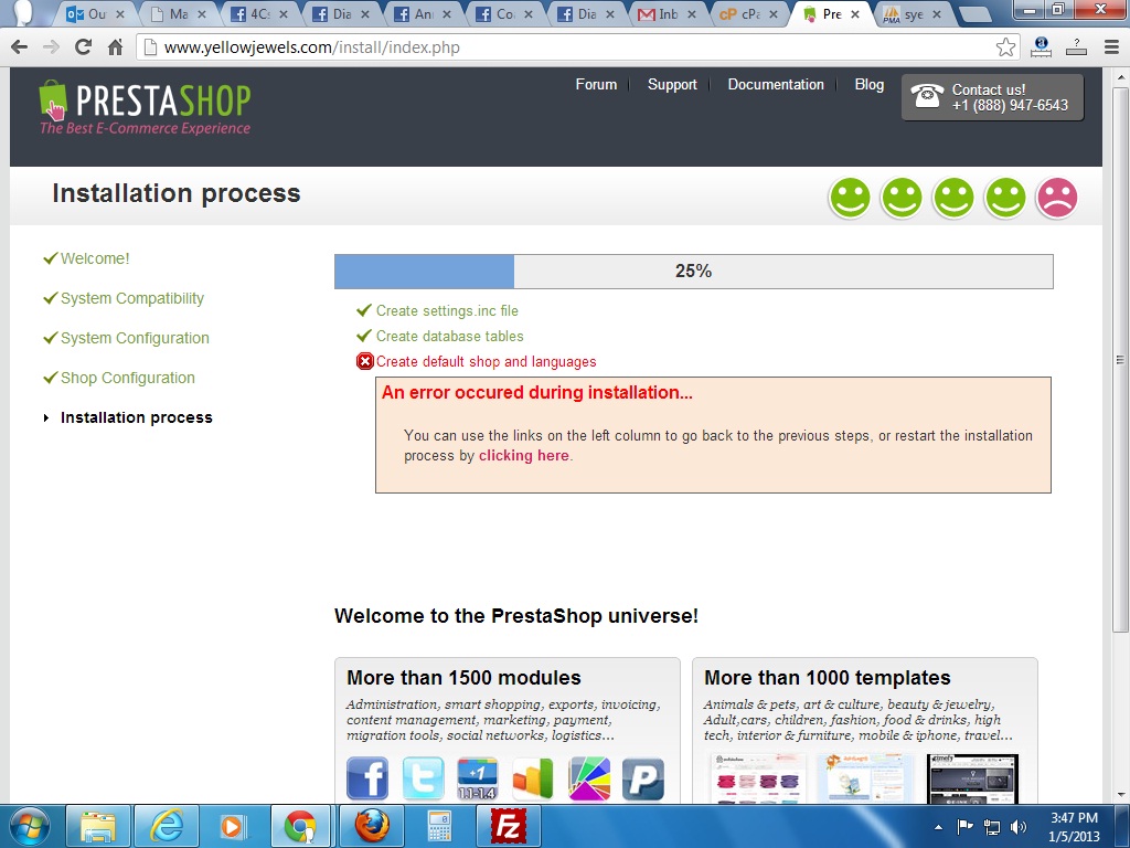

Aftabbajaj Posted January 5, 2013 Share Posted January 5, 2013 Please help me to install Prestashop For Ecommerce Website ,I am Facing a lot Problem . 1 Link to comment Share on other sites More sharing options...
avrafamily Posted January 11, 2013 Share Posted January 11, 2013 Please help me to install Prestashop For Ecommerce Website ,I am Facing a lot Problem . the same problem, anyone can give a sollution for this? Link to comment Share on other sites More sharing options...

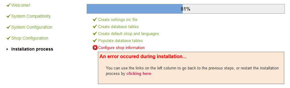

beyzad Posted January 12, 2013 Share Posted January 12, 2013 Hey guys. Same for me. but at 51% Link to comment Share on other sites More sharing options...
beyzad Posted January 13, 2013 Share Posted January 13, 2013 Hi. Found it guys. Just try to install using United states as your default location and US as your default language. I hope this help. Link to comment Share on other sites More sharing options...

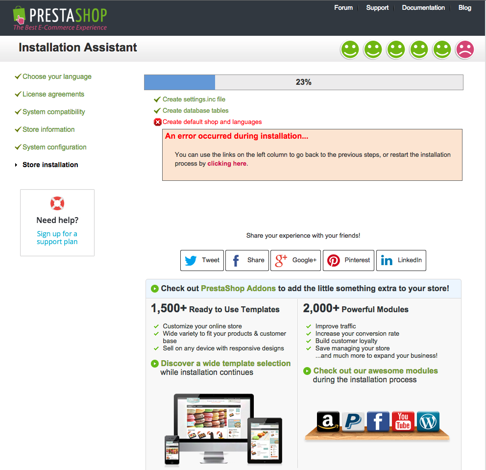

bluehatch Posted July 1, 2013 Share Posted July 1, 2013 same problem !! i need help, it stucks at 23% Link to comment Share on other sites More sharing options...
vekia Posted July 1, 2013 Share Posted July 1, 2013 hello,what language pack you're trying to install? please try with default one, then you will be able to import your localization pack in back office. are you connected to the internet while installing? Link to comment Share on other sites More sharing options...
bluehatch Posted July 2, 2013 Share Posted July 2, 2013 the server enabled ini_set() now it works fine! Link to comment Share on other sites More sharing options...
vekia Posted July 2, 2013 Share Posted July 2, 2013 thanks for information! im convined that you information will be helpfull for another merchants with similar problem. i've got additional question: by "the server enabled ini_set()" you mean that your hosting provider changed something in the server configuration? Link to comment Share on other sites More sharing options...
bluehatch Posted July 2, 2013 Share Posted July 2, 2013 thanks for information! im convined that you information will be helpfull for another merchants with similar problem. i've got additional question: by "the server enabled ini_set()" you mean that your hosting provider changed something in the server configuration? yes, i was very confused, almost going to use oscommerce, but the admin set ini_set() enable and now the store works perfect! no issues on the installation.. Link to comment Share on other sites More sharing options...
coronatonewmedia Posted July 7, 2013 Share Posted July 7, 2013 what does "the server enabled ini_set()" mean exactly? I'm havign the same problem on Godaddy linux server, same 23% error Link to comment Share on other sites More sharing options...
vekia Posted July 8, 2013 Share Posted July 8, 2013 it mean that you have to change the server configuration. If you're on shared hosting you have to contact with your hoster, ask them for turn on ini_set() php feature. Link to comment Share on other sites More sharing options...

artemu78 Posted July 10, 2013 Share Posted July 10, 2013 (edited) Same Installation error, stack on 23% Create default shop and languages How is possible to enable ini_set ? I`ve seen php.ini and there is no any disabled function There is no any explain of this error, is there any installation logs ? ZettaHost provider Php 5.2.17 PrestaShop 1.5.4 Edited July 10, 2013 by artemu78 (see edit history) Link to comment Share on other sites More sharing options...
vekia Posted July 10, 2013 Share Posted July 10, 2013 what language pack you're trying to install? Link to comment Share on other sites More sharing options...
artemu78 Posted July 10, 2013 Share Posted July 10, 2013 what language pack you're trying to install? I`ve tried english, tried russian. I`ve tried to edit install/langs/en/language.xml from <language_code>en-en</language_code> to <language_code>en</language_code> And same with russian language.xml (ru-ru to ru) All i got is error on next step Populate database tables And again no any little error explain. Not a single code line. Why is that? Why it has no logs and no Error explain? 1 Link to comment Share on other sites More sharing options...
swsindonesia Posted August 3, 2013 Share Posted August 3, 2013 Hi, I hope this late reply can help shed some light, This is definitely a internet connection problem between your server and prestashop server Maybe your hosting provider doesn't allow http request from inside your account. To confim my statement, when you have a working internet connection and installing PS, you should be able to view additional banner from prestashop addons below the progress bar As how to fix this by passing-through the internet connection issue, is by (1) pre-download the language pack (2) overriding the request to your own domain see: classes/Language.php line: 696 if (!$lang_pack) $lang_pack = Tools::jsonDecode(Tools::file_get_contents('http://www.prestashop.com/download/lang_packs/get_language_pack.php?version='._PS_VERSION_.'&iso_lang='.$iso_code)); 1 Link to comment Share on other sites More sharing options...
artemu78 Posted August 3, 2013 Share Posted August 3, 2013 Hi, I hope this late reply can help shed some light, This is definitely a internet connection problem between your server and prestashop server Maybe your hosting provider doesn't allow http request from inside your account. Yes, you right, my hosting provider did not allow outgoing connections. Now problem is gone. Link to comment Share on other sites More sharing options...
vekia Posted August 3, 2013 Share Posted August 3, 2013 that's right, i suppose that function file_get_contents is disabled it's necessary for prestashop - not only for installation process, also for other things like currecy exchange rates, importing localization packs etc. Link to comment Share on other sites More sharing options...
