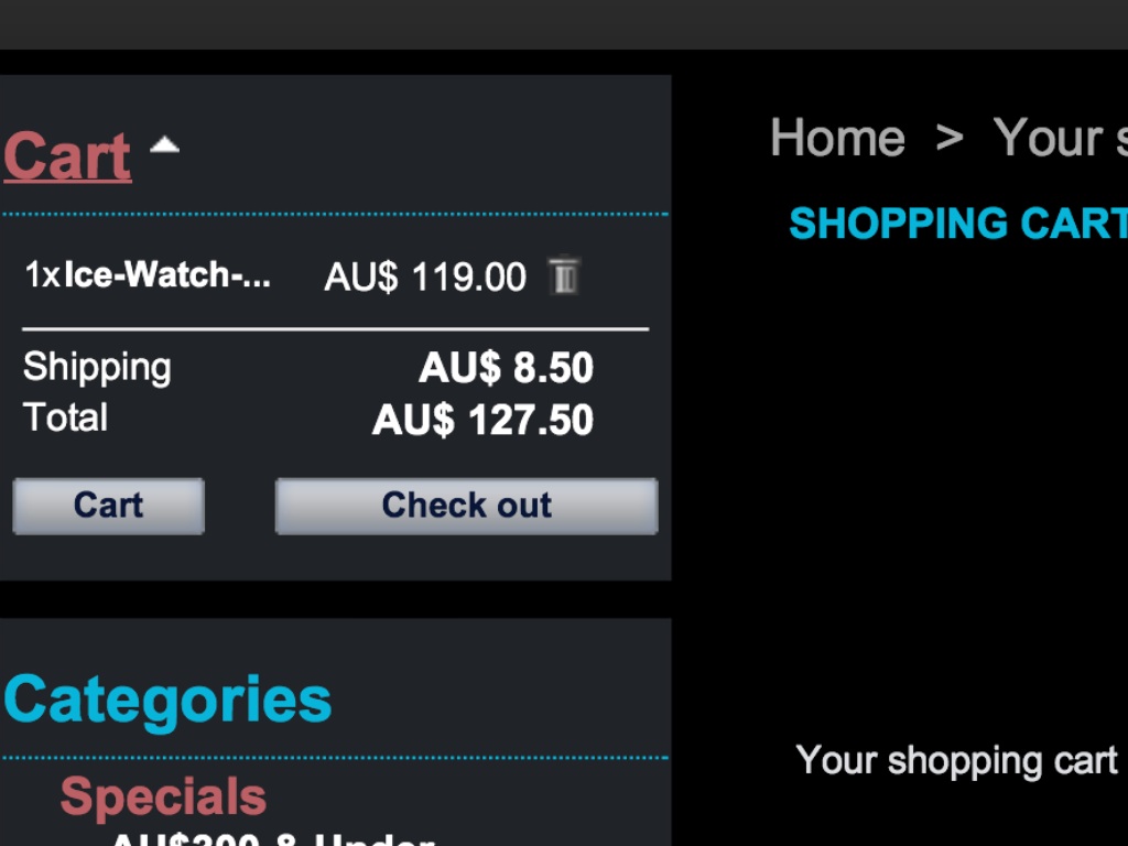

kansas3d Posted January 5, 2013 Share Posted January 5, 2013 (edited) Hi everyone, When I'm activating "One page checkout" at BACK OFFICE > PREFERENCES instead of "Standard (5 Steps)", I'm getting a blank page when I'm clicking at Checkout. Does someone know how to fix this problem? And another thing is, that the button CART next to CHECKOUT disappears when I switch to "One page checkout". You can see on the pictures one picture before with the 5 steps. There CART still exists and the page has content on the rig side in the content area. The second picture is the one page checkout with the missing CART button and no content at all in the content area Thank you Edited January 5, 2013 by kansas3d (see edit history) Link to comment Share on other sites More sharing options...

kansas3d Posted January 6, 2013 Author Share Posted January 6, 2013 Thank you Alaxander for your help! In my config/config.inc.php was: /* Debug only */ @ini_set('display_errors', 'off'); define('_PS_DEBUG_SQL_', false); and I changed it to: /* Debug only */ ERROR_REPORTING(E_ALL); @ini_set('display_errors', 'on'); define('_PS_DEBUG_SQL_', TRUE); But now I'm getting the following Error message: Warning: Smarty error: unable to read resource: "/home/content/23/10076423/html/home/themes/linda/order-opc.tpl" in /home/content/23/10076423/html/home/tools/smarty_v2/Smarty.class.php on line 1095 Do you know what the problem is? Is it correct that it is redirecting to order-opc? The Standard 5 Steps Checkout redirects I think to order.php and not oreder-opc. Thank you a lot Link to comment Share on other sites More sharing options...
Alex Simonchik BelVG Posted January 6, 2013 Share Posted January 6, 2013 It's meen that your theme dosn't have order-opc.tpl. You may check it into folder: themes/linda. Try to copy order-opc.tpl from default theme into your theme (into themes/linda). Link to comment Share on other sites More sharing options...
kansas3d Posted January 7, 2013 Author Share Posted January 7, 2013 Thank you Alexander! You are awesome! It worked by copying order-opc.tpl into the linda theme folder. Thank you so much Link to comment Share on other sites More sharing options...
