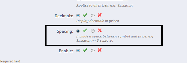

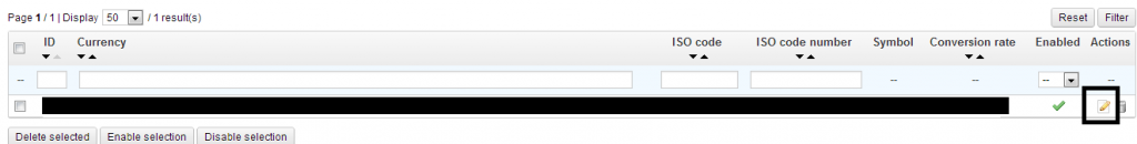

nadie Posted December 30, 2012 Share Posted December 30, 2012 There is a space between the currency symbol and the price digits. Is it possible to remove it? I have tried to edit the codes in products.tpl but I only see {convertPrice price=$productPrice}. Is it possible to remove the space? I have attached a screenshot of the problem. Hope it will clarify what I'm trying to say. Thanks! Tab Localization -> Currencies Edit Currency When editing the currency, look for the following option: In "Spacing" select: "X" ----- Sorry for my English 3 Link to comment Share on other sites More sharing options...
pathetix Posted December 30, 2012 Author Share Posted December 30, 2012 Wow, didn't thought there would be an option in the admin. This is great, thank you for taking your time to answer my question. I really appreciate it Link to comment Share on other sites More sharing options...
