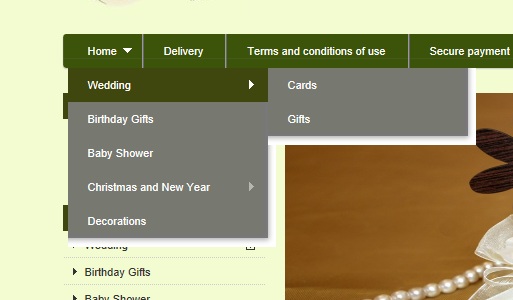

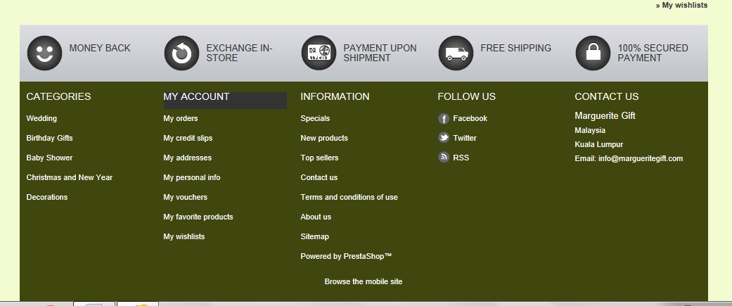

Marguerite Gift Posted December 27, 2012 Author Share Posted December 27, 2012 I appreciate your help. I was able to change colors as I wish. But I got two problems: First: I'm not able to change the color of the drop-down box on the top menu as you may see on the attached picture. Secondly, on the footer part, I changed the color but as you could see on the attached picture, the color of "My Account" part is still black. I was wondering how to change the color entirely. Thanks your reply in advance. Link to comment Share on other sites More sharing options...
tdr170 Posted December 27, 2012 Share Posted December 27, 2012 (edited) You have to change the following: (top menu) .sf-menu li li { background: rgba(113, 113, 113, 0.9); } .sf-menu li li li { background: rgba(113, 113, 113, 0.9); Like this (your colors) .sf-menu li li { background: green; } .sf-menu li li li { background: yellow; For footer go to ..modules/blockmyaccountfooter and edit blockmyaccountfooter.css and change the following: change this #footer .myaccount h4 { padding:0 0 10px 0; background:#333 to this #footer .myaccount h4 { padding:0 0 10px 0; Edited December 27, 2012 by tdr170 (see edit history) Link to comment Share on other sites More sharing options...

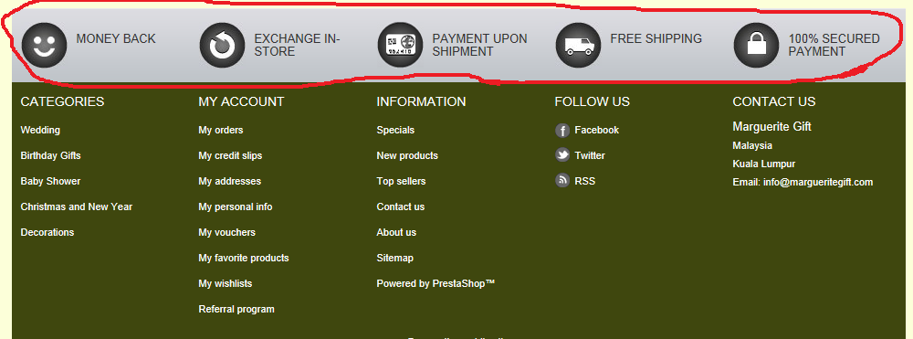

Marguerite Gift Posted December 28, 2012 Author Share Posted December 28, 2012 Thanks, it did the job! Further more, I need to change the gray color of the footer top as well ( on the attached picture) . There is no Module for footer. How can I access this part? Appreciate Link to comment Share on other sites More sharing options...
tdr170 Posted December 28, 2012 Share Posted December 28, 2012 Yes there is its called blockreinsurance. look for style.css Link to comment Share on other sites More sharing options...
