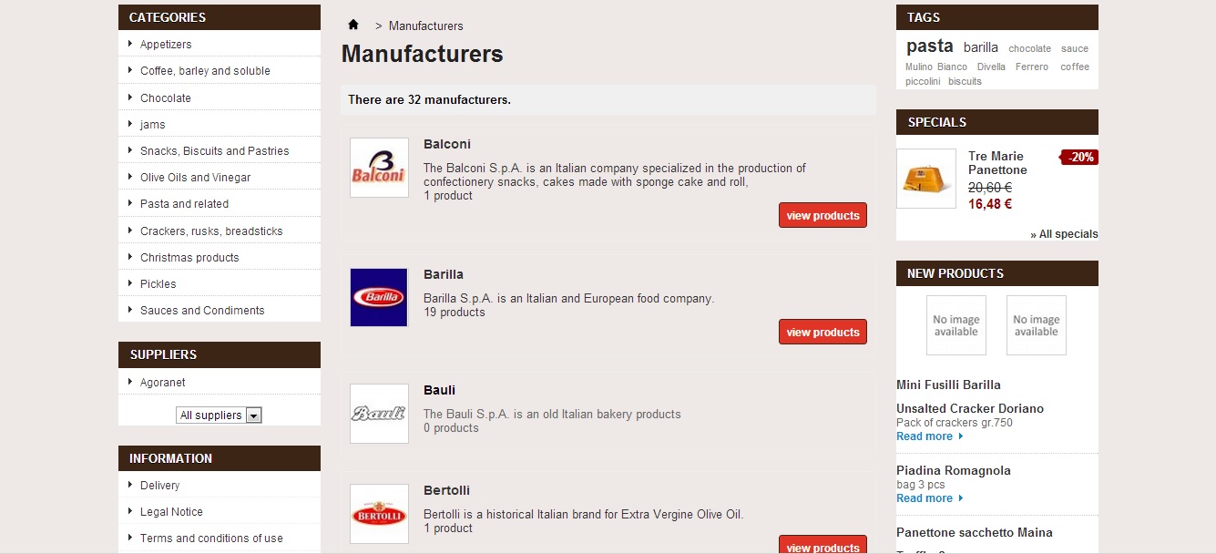

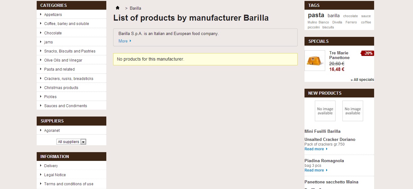

Pikkuweb Posted December 15, 2012 Share Posted December 15, 2012 Hello! Can someone give me some advise about this problem: the site doesn't show the list of products when I select a manufacturer.If I check the list of manufacters, it shows all manufactures, and who has how many products. But when I click on show the products, the page says there are no products of this manufacturer. I tried to check for firebugs, but it doesn't give any warnings for errors. It seems like I don't have really any products for that manufacturer.... My version of Prestashop is 1.5.2.0 Thank you for your help! Luca Link to comment Share on other sites More sharing options...

Pikkuweb Posted December 20, 2012 Author Share Posted December 20, 2012 Ciao! What i did to fix the problema was this: Hi, seeyei, If you really need supliers, try to change in Preference -> Products ->Default order by: Position inside category - NOT Product added date. It should work in Presta 1.5.2 (this is bug) or try to change in phpMyAdmin in table ps_configuration PS_PRODUCTS_ORDER_WAY = 1 on 1 PS_PRODUCTS_ORDER_BY = 2 on 6 in second way you will have available products at the top of list. sorry for my english regards We changed directly from the Data base, because from the backoffice doesn't work. Probably me or my co-worker change the configuration, but then it doesn't changed anymore... The same problem with some traslation... often i don't succeed to edit the traslation.. Even i try to save it they doesn't change. Actually i must say that the 1.3. and 1.4 was working better ... but fortunally still the manual edit works always Link to comment Share on other sites More sharing options...
