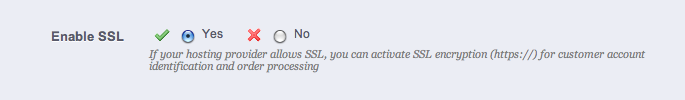

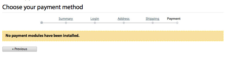

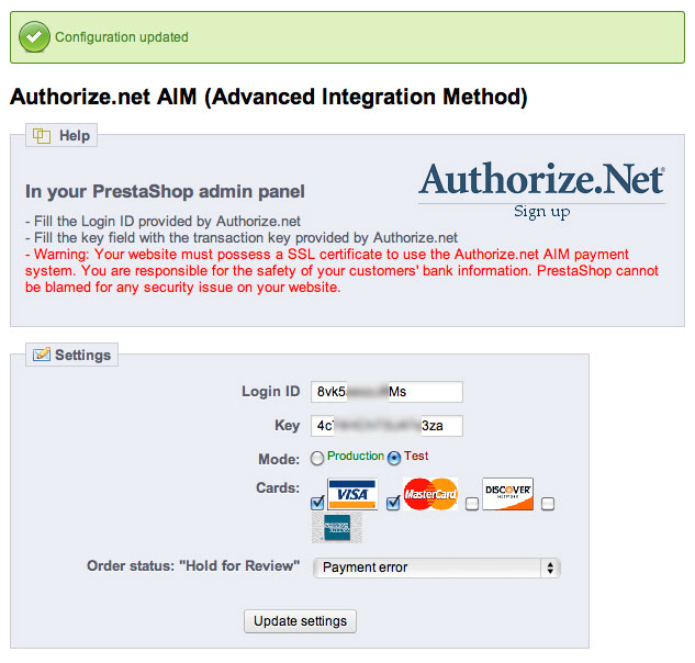

edzio Posted December 13, 2012 Share Posted December 13, 2012 I recently installed the Authorize.net payment module (http://addons.prestashop.com/en/payments-gateways-prestashop-modules/4423-authorizenet.html) but after filling out the information it will not show up on my checkout, rather I am given the error message 'no payment gateways installed' The module config page shows a warning saying my site requires SSL, but I already have it and enabled in prestashop (and checking out on my store confirms the url going to https) My credentials were confirmed by Authorize.net and they said to contact Prestashop regarding this issue. So far my searches of the form have found only one solution that required modifying the module but that had no effect. I have even re-downloaded the module to ensure I have the most recent version. My prestashop install is version 1.5.1.0 Link to comment Share on other sites More sharing options...

edzio Posted December 13, 2012 Author Share Posted December 13, 2012 On 12/13/2012 at 8:55 PM, clayton29657 said: Hi edzio, I can only tell you from what I have read on forums read this and hope it helps you. http://www.prestasho...095#entry968095 Cheers Clayton Unfortunately that doesn't relate to my problem though, I mentioned SSL is enabled in Prestashop and working (I attached a screenshot in my original post with the admin SSL config page, below is the database confirmation). This is an issue with the Authorize.net module it seems, which Prestashop developed. Has anyone else had this issue? Link to comment Share on other sites More sharing options...

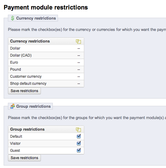

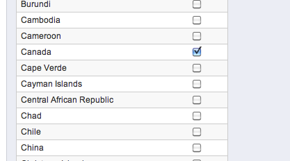

Dh42 Posted December 13, 2012 Share Posted December 13, 2012 In the modules menu, click on payment from the drop down. Authorize.net uses two chaned gold boxes for its logo, make sure that it is enable for canada and for the customer group. Link to comment Share on other sites More sharing options...
edzio Posted December 13, 2012 Author Share Posted December 13, 2012 (edited) Ah right, I remember that page: It is enabled for Canada and all customer groups, Currency however cannot be edited. I re-saved my restrictions, but no change. Edited December 13, 2012 by edzio (see edit history) Link to comment Share on other sites More sharing options...
Dh42 Posted December 13, 2012 Share Posted December 13, 2012 Hmm, try activating the bankwire module and see if it displays on the payment page. You cannot select currency with auth.net, they only accept USD. Link to comment Share on other sites More sharing options...
edzio Posted December 13, 2012 Author Share Posted December 13, 2012 I enabled bankwire and it does show up during checkout. My store is set to have Dollar (CAD) as it's default currency, though it does not look like switching it to USD made a difference in regards to this issue. Dh42, if I send you login details would you care to take a look at the backend? Link to comment Share on other sites More sharing options...
