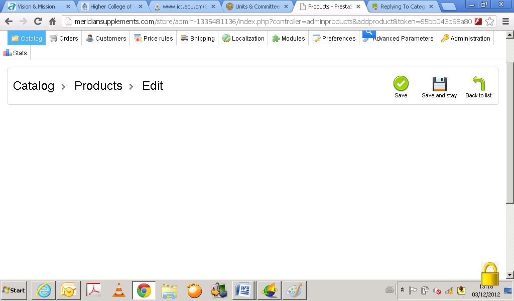

meridiansupplements Posted December 4, 2012 Share Posted December 4, 2012 Hi, i have the same problem. Here is a screen shot of how my add products page looks like: Link to comment Share on other sites More sharing options...
tomerg3 Posted December 4, 2012 Share Posted December 4, 2012 Turn on error reporting in /config/config.inc.php line #28 and try it again, you should see some sort of error. Link to comment Share on other sites More sharing options...
